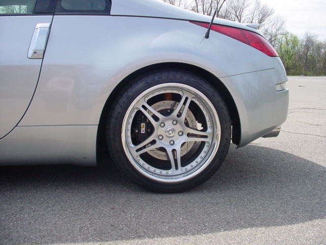

I have just installed the rear AP kit. I have to say that I did not notice if the studs were too short for any of my 3 sets of wheels. They fit under stock 18's, HRE 547R 19" X 10" offset ??, & Volk CE28N 18" X 9.5" offset 34. When I ordered the HRE's I allowed them to figure the offset with the understanding that a BBK was going to be installed.
