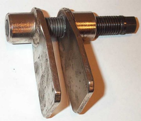

Old Jan 11, 2005 | 05:43 PM
Major's Avatar
Major
Posts: 106
From: Yuma AZ
Default You Want One Of These!
DZeckhausen,
It apears this tool will slide down inside the caliper and compress the pistons, correct?
How do I get one & how much?
Thanks
Major
Attached Thumbnails HAWK HPS issues w/ brembo calipers-calendar22.jpg
Old Jan 11, 2005 | 05:57 PM
DZeckhausen's Avatar
DZeckhausen
Posts: 251
From: Maplewood, NJ
Default Re: You Want One Of These!
Originally posted by Major
DZeckhausen,
Major,
I bought this tool back in 1994 to change the pads on my 3rd Gen RX-7 Twin Turbo. It was a Mazda Special Service Tool (SST) and I think it cost about $35. I thought a quick Google search would find multiple sources for it, but I came up empty. Sorry!
You could print out a photo of the tool and bring it to your local Mazda parts counter.
Dave
