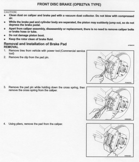

The rears were okay but all four front pads required filing in order to get them to fit.
Did not take much filing, but just a real pain in the *** after spending funds to buy them! You would think they (HAWK) could have done a better job!
