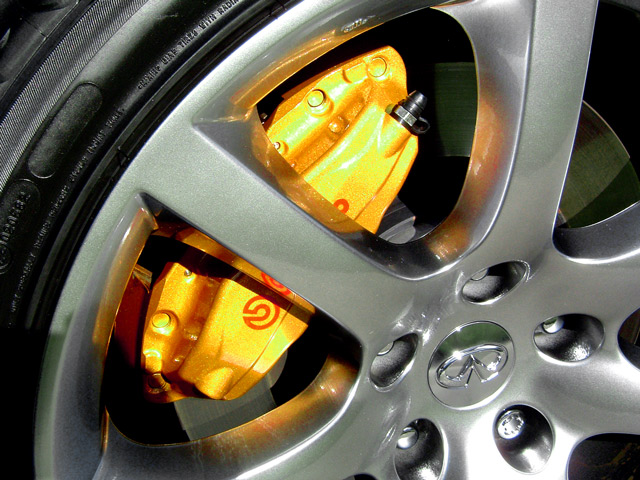

firstly........
i hate the brake mess/slop/dust/flem from oem
i am smitten with how clean and lean the HPS's are, even if its only been a few coupla miles......
issues::
fitment of the front pads........ they didnt seat in the caliper housing (well, maybe with a hammer!0 and i had to have them shaved down a little to get them to fit, without jamming them in....
while they were being shaved (i never witnessed how much, unfortunately) i was busy being A.R. and waxing the inside of the wheels (at the dealer is where all this happened)
so now that they fit, i am on my way home, braking and bedding altogether.....
so i try, (dont know why) a reverse brake stop (in a parking lot....) and then it starts...
CLACK
i put it in 1st, and accelerate forward... then apply the brakes again...
CLACK
reverse it, and touch (light or heavy footed, it doesnt matta) the brake pedal
CLACK
not sure if its the Fronts(only), or left side (only) or all......what.......
WTF?? help????
it sounds as if the pads are actually shifting in the cliper body, but how??? there are two alignment rods (as i know everyone knows) that keep these pads in check.... how are they shifting, or twisting??
i am afraid this will lead to something maybe worse, plus, my car only has 300 miles on it, so......
what can i do?? or, what can i expect the dealer to do?? i really dont wanna go back to the oem pads.....(will buy new fronts if there is an install technique that was missed)
please lend me a moment, and let me know your opinion
i bought these pads from mario at www.tirerack.com, and was under the impression they would be great and direct replacements.... (granted, non-oem is just that....non-oem)
