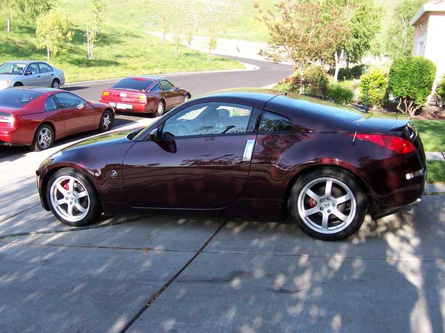

i also used the g2 paint on mine. looks nice. very easy to do once you get the tires off and car up on the jackstands.
heres a pic:
