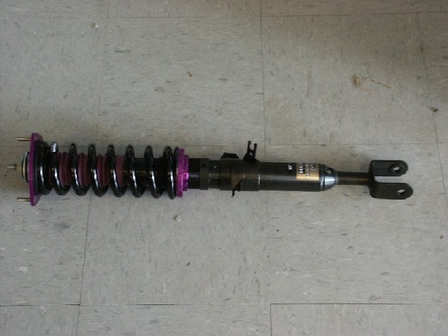

front coilover
Attached Thumbnails hks ls+ coilovers/nismo sways...review..pics-hksfront1.jpg

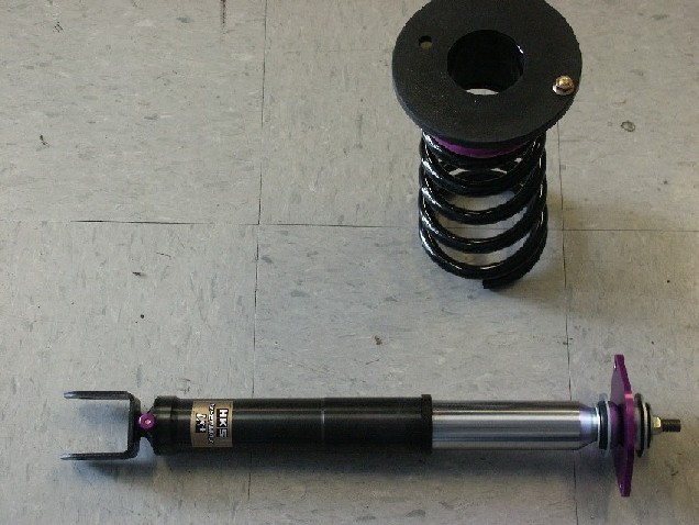

rear coilover
Attached Thumbnails hks ls+ coilovers/nismo sways...review..pics-hksrear3.jpg

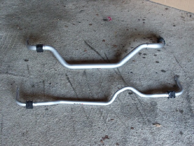

sways
Attached Thumbnails hks ls+ coilovers/nismo sways...review..pics-nismosways1.jpg

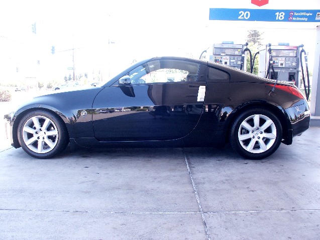

before
Attached Thumbnails hks ls+ coilovers/nismo sways...review..pics-stock1.jpg

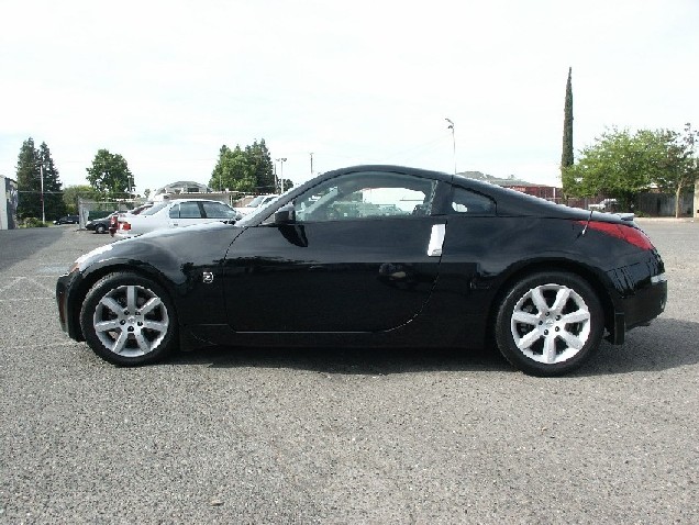

From: cali
after

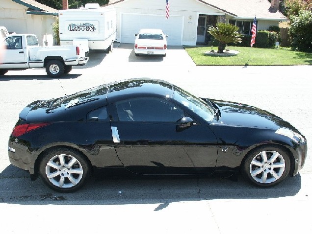

From: cali
another

one other thing to note about the LS+ is that the rear dampening adjustment is near the bottom of the shock, instead of the top. this makes adjustment easier (actually it makes it possible). also, if you notice the design of the rear shock, it is an inverted design, in the sense that all of the weight is in the rod (the chrome part). this reduces unsprung weight. other brands have all the weight in the bottom, and a small rod to connect to the pillowball.
