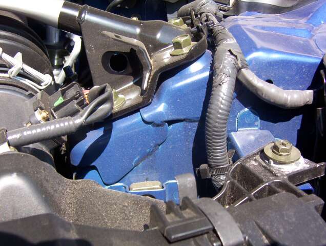

If you look at the metal the stock bar is mounted to (see pic), it is kind of a hack anyway. This is not an extemely secure mount to begin with, and you can tell it is a factory afterthought welded in at the last minute.
The mounting brackets are very strong, probably stronger than the mounting brackets welded into the inner fenders. You aren't going to get anymore flex. Plus, the factory bar has a curve to it in addition to having less strength than Doug's bar to begin with. A curve would be weaker than a straight bar (which is also thicker I believe).

You can disagree if you want, but look at the limited number of welds in the pic above and tell me that is optimal. In a lot of cars, the bars are attached directly to the top of the strut or shock mounts. These are not, they are hacked in with stands made as an afterthough (the G35C doesn't have this at all).
Again, if you look at Doug's brackets, they are very beefy, and they are probably much stronger than the welded in mounting plates Nissan installed.
