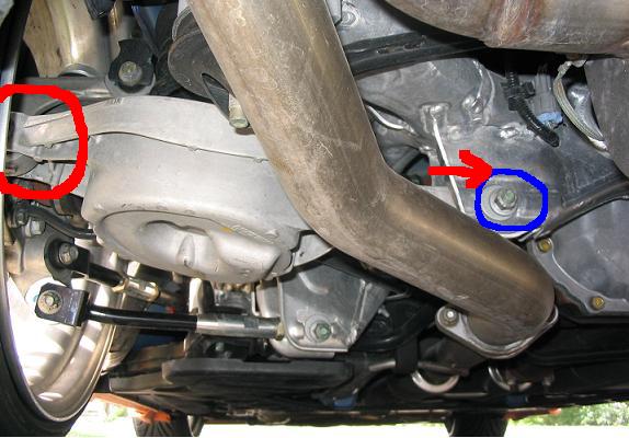

I bought a toe and camber kit from stillen thinking it would fix my camber since my camber is very bad from lowering my car. Sure it fixed it a little bit but its still bad, I could bring in the camber where it sits my wheel flat on the ground but then the toe is way off because I could only go so far with the toe being maxed out. I went to two wheel shops here to see if I'm missing something.
Well this is the problem, the picture below shows why I can't get the toe straight. The arm that holds the rear spring and helps adjust the toe is still limited and basicly is fixed in one position. We moved it as far over as we can but it doesn't help at all. The blue circle shows the adjustment to allow some movement.
So, what I'm asking is ,stillen or someone to make a kit to adjust this problem.

Heres what it looks like now with everything adjusted to the max without going very negitive on the toe. Its a little better now but still not good enough. I wanna go lower but then my camber will be just as bad as before.

You've already been given the only correct answer by al503, that is the only correct way to adjust more toe at the proper oem location. Adjustable radius rod's are not the way to effect toe change on these cars, Nissan adjusts toe where it does for valid reasons.

Most of the following was written by someone else, but I don't see the point of saying the same thing in my own words.
Yes, the traction/toe rods made by LSD unique aka Kinetix, JIC, Stillen ect, are more accurately named a adjustable RADIUS ROD. That is the correct name for the arm, just look it up in the shop Manuel.
These rods do not adjust toe. Due to their mounting point they cannot adjust toe WITHOUT affecting the caster change.
The radius rod (misnamed toe rod's) attaches to the spindle right on the pivot point between the upper and lower ball joints. It does not attach in front of the pivot point like some believe.
Lengthening or shortening of this rod only changes the caster of the spindle because the rod is below the rear axle. So, lengthen the rod and the less caster you get.... Shorten it and you get more caster.
Sure... some say that they have lengthened it and it adjusted toe. That is only because the caster has changed so much that the pivot point between upper and lower ball joints has been relocated..... due to the traction rod not being mounted perfectly centered between the upper and lower ball joints the entire rear geometry gets changed to the point that toe was affected.
This is the WRONG way to adjust your toe. I would call this a static toe adjustment. This may work as long as your rear suspension never moves. As soon as you corner hard, accelerate and squat or hit bumps and cause your rear suspension to become dynamic things can get nasty.
The proper way to adjust toe is with the stock toe cam or a aftermarket toe cam with greater range.

What is exactly toe cam and where it's located in suspension?
look in this pic, it's the bolt that the arrow to the right is pointing to.
