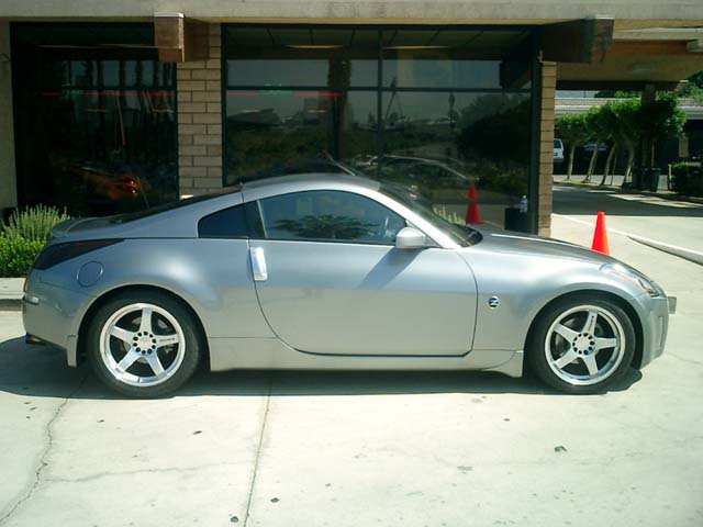

as per nismo specs, it lowers by 20mm or .66". front wheel well gap is practically diminished. rear wheel well gap is quite large, still...
Old Nov 17, 2004 | 02:47 PM
SHO-TIME's Avatar
SHO-TIME
Posts: 3,322
From: Tokyo, Japan
yup... 2cm. Here is mine taken at Performance Nissan from the side.
