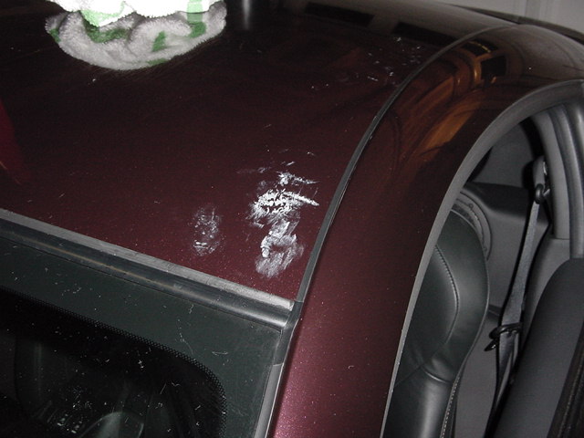

Well, this is the first time I've clayed a car, and I'm using the Meguiar's brand. I didn't use quite enough lubricant so now I've got some clay that is sticking to the car!!! see pic.
No matter what I've tried I can't get the clay off, I've tried Dawn, vinegar solution, Zaino Z6. The clay only gets spread around more and it looks worse!
Would appreciate any advice from any of the detailing experts... thanks!!

I'm not sure what kind of clay you are using but the kind I used if much firmer and even without lube it couldn't do that. It is kind of like silly putty consistancy. It was the Zaino putty.

It's not really like silly putty, more like taffy, it has a very sticky surface without the lube. Even with the lube it still leaves these gross streaks in the paint. VERY frustrating. I've PM'd Brad, hopefully he can help. I can say to everyone on this site, STAY AWAY FROM MEGUIAR'S CLAY! I'm going to call them up tomorrow and give them an ear-full....

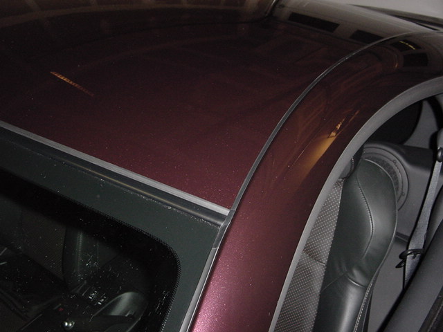

Whew! It does come off, you have to wait for the clay to dry, and then it's just old-fashioned elbow grease, but STILL! It shouldn't be this hard... I'm still going to call Mequiar's and ask them what the hell is up with this product.

UPDATE: I thought I had removed all the clay, but I can now see a thin white film from certain angles in the spots where the clay was. I called up Meguiar's and they said I had to go buy a special paint treatment to get the film off. Talk about total BULL$(&*!
DO NOT USE THIS STUFF.

I've used Pinnacle's clay bar and never had it come apart like that before. Before getting that paint treatment stuff you might want to try a paint cleanser first.
