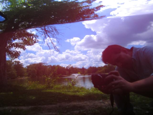

Looks like it came out pretty good. If you can see yourself in the reflection of the paint when you take a picture then you're doing it right! LOL

You mean like this?

dr that car is insane clean, damn good job

Wow... just wow. Doc, you are da man.
