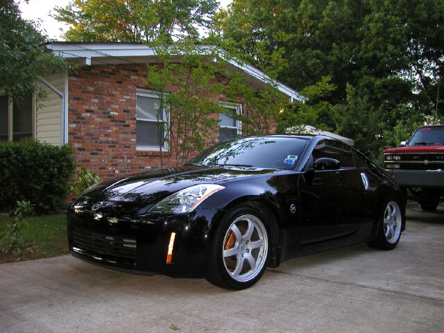

Thanks for all your help and suggestions, here is the final version after 2 coats
Attached Thumbnails Zaino questions I haven't found on Search..-350z-hotness.jpg

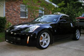

wow that was a small pic here is a bigger one
Looks awesome.........
