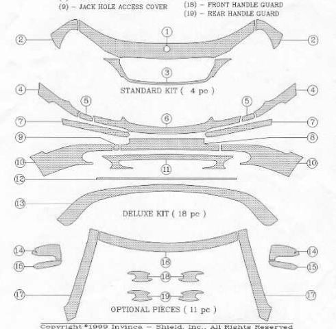

My shop is a climate controlled sealed vent-less building with a three micron filtration system and 5,000 watts of lighting. Don't compare a class setup to what you driveway installers do.
your s500 kit

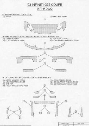

Lastly, let's discuss the wrap around hood design that you claim is so good. The film adheres best on clean surfaces. I don't know what you have under your hood but I have dirt, oil and grease, not to mention high temperatures under mine. At Invinca-Shield we intentionally DO NOT WRAP AROUND AND UNDER HOODS because that area is most susceptible to poor adherence. And once the film releases from the under side of the hood, it is only a matter of time before it starts fraying between the hood and the body when you raise and lower the hood. I think after a few months of use you may want to recant your testimony, Cato.
We, at DynaShield spend two to eight hours just cleaning and prepping the surface for installation. We do this because our customers demand the best. Depending on the wax, we may etch it with a mild alkali cleaner. We then wash the car again with a non reactive car wash. Then we take the car into the shop and wash it again with a non-reactive and distilled water. All edges are cleaned first with a solvent and then the surfactant with distilled water.
"fraying between the hood and body"? Show me a car with only 16 mils of hood clearance and I'll show you a car that needs the body shop.
your g35 kit

In the case of the 350Z our extra relief slits and 7 piece design allows even moderately capable installers to do a good job. What good is paint protection to the general public if only 6 people in the entire US can install it well and only a few can afford it? And yes on the 2003 Infiniti G35 Coupe we did intentionally split the front bumper for ease of handling and installation. By the way, all those extra pieces on the 350Z and G35? They are cab top, door pillars, protection for behind and in front of both front/rear wheels and door handle cups. Why? Because our customers told us they wanted those options.
The S500 design goes back to 1999 (as noted on the face sheet)and represents an excessive amount of pieces even by my standards. None of those design guys work for us anymore. They are out on their own at XXX-shield (I'm not kidding, I'll give you the name privately) still making kits the same way. Look at our newer kits and you'll see a much better balance between number of pieces and one piece construction.
When film comes loose from underneath the hood it most certainly can chaffe when opening and closing the hood. The clearance you mention is only appropriate when everything is adhering correctly.
