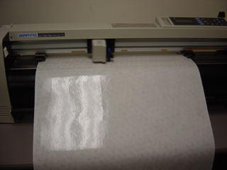

Pic2:
Film being cut

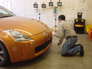

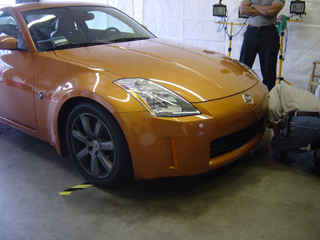

Before...

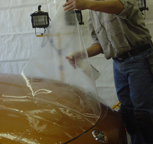

Applying film

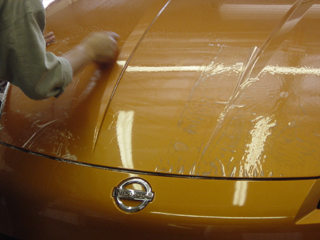

Smoothing out the film - squeegeeing the lubricant out from under the film and stretching where necessary.

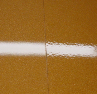

Finished - heres the "seam" where the coating stops ont he hood.

Jeremy, I have an LS too and had the bra installed over a month ago here in Phoenix.
Let me give you some caveats realized from my install.
Initially, things looked good upon completion, tho I wasn't sure what I should be looking for.
In about a week, lines or stretch marks began to show up, especially around large curved areas. They worsen almost by the day after the first 10 days or so. Next, bubbles began to form in the two seams running down the center of the hood. This really set off the alarms because others could see this too. Also, make sure they have the material tucked all the way in/up to the bottom of the headlights. I didn't see this gap initially and now I see a full 1/2" gap under the drivers headlight on one side. They responded to my complaint by saying that the company is making a brand new pattern because they were having problems with the install on that pattern. They said the new pattern would be ready this coming week and they are going to do it all over again.
I am very pleased with the concept and the material. I have 11,000 miles on the car and about 8,000 miles with the bra on and it has saved me many, many times. It is just an install problem that I am dealing with over here. Watch yours closely and keep on the installers if things start to show up. Regards, Jim

Jim,
Those bubbles on the hood creases are a very tough area. I haven't had to warranty a hood yet but if I do, I bet that will be the problem. I guess I am trying to say that as long as he is going to fix it, I would not sweat it too much. He should be willing to do a touch-up on the other areas.
I can say that there is no way to cut that hood to make the area easy. If it is not down perfect, bubbles will form in the groove. Hopefully he will have better results next time. What brand of kit was he using?
Lines and other blemishes will come and go for a couple of months. In time the material will smooth some, but not completely. Remember, you are putting on a tough, fairly thick film in order to protect your car. It is an alternative to a vinyl bra and it's looks. It is not a factory clear coat.
At DynaShield, if the customer is not happy with the product, we will either do what the customer wants to make it right or remove the entire bra and give a full refund.
