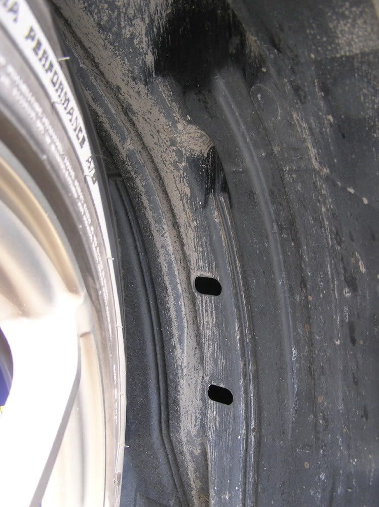

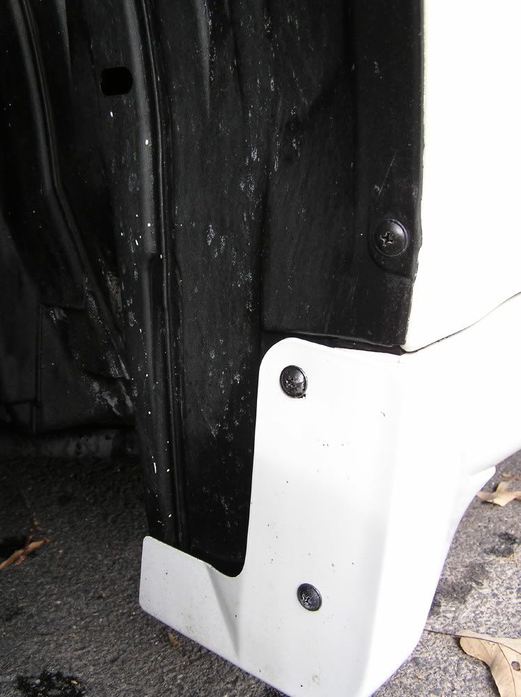

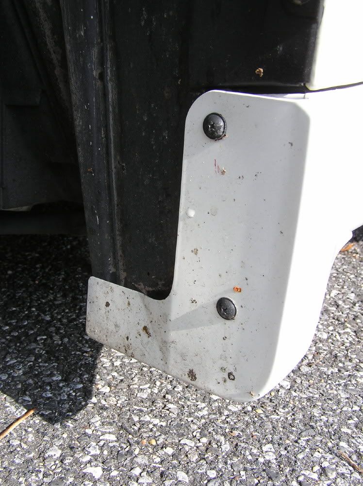

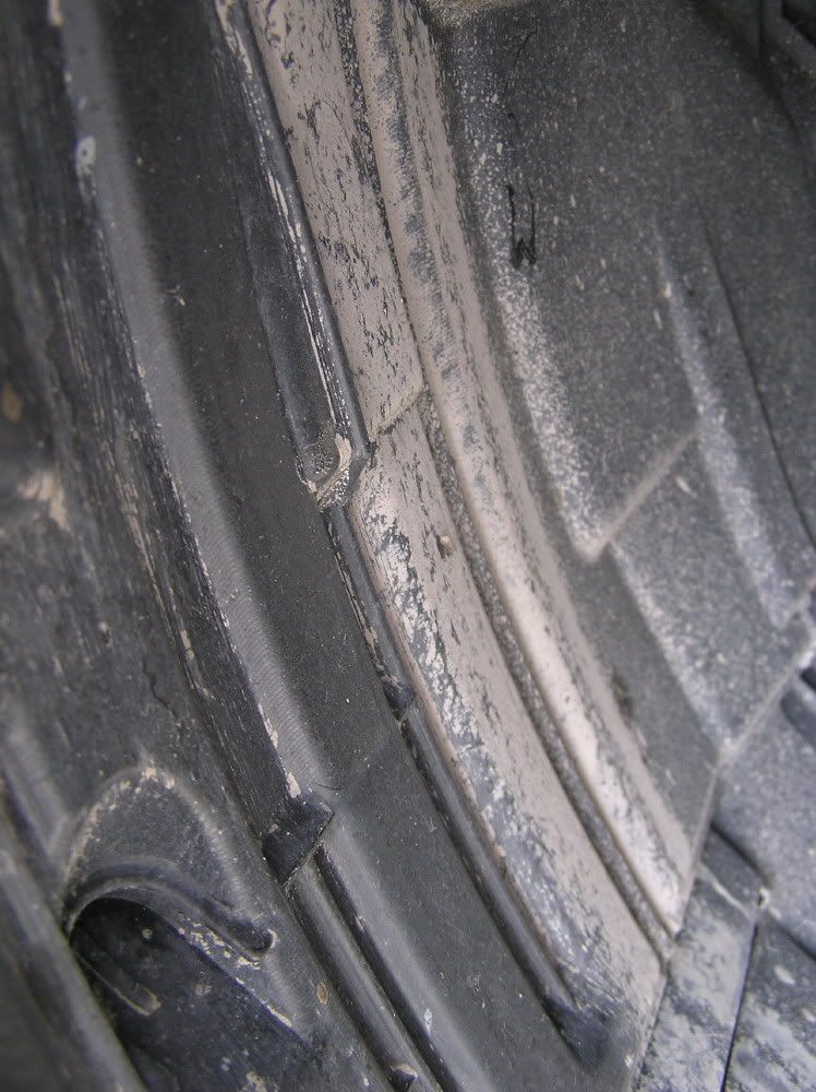

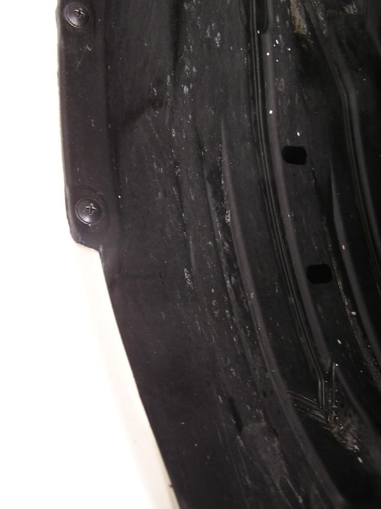

If you ever get cement on the car you know how difficult it is to remove. Once dried it will bond to almost any surface. Soap, water and common solvents will not touch it. Here are the before and after results of Back-Set. Very pleased with the results.
