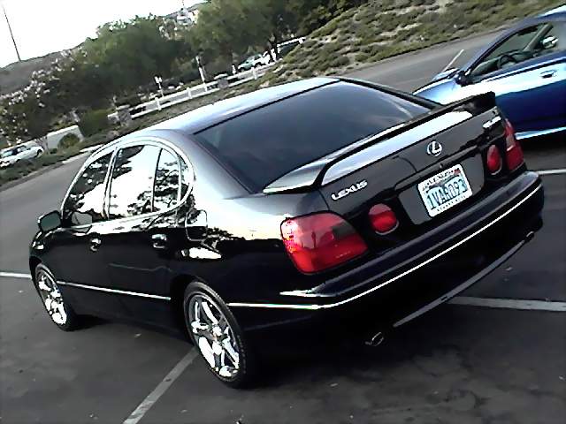

Once more pic, more available here:
http://www.everythingcelica.com/gal2/20020818?&page=5
BTW: Ok? If you feel like picking apart this post too, feel free to redirect everyone to Autopia...where they'll be able to read the exact same thing.
~Jeron

Geeze. By the time you get this done, it rains or it's time to trade it in, or you drop dead from an embolism caused by excess buffing.
It does look nice but I have a feeling the pics don't do it real justice.

Yah I know... I reall need to get a decent digicamera...that is after I pay off the 3k for the T-ho...and however much the new rims are gonna cost me...but after all that, I'm all for a new camera.
For now, my digivideo camera will have to work.

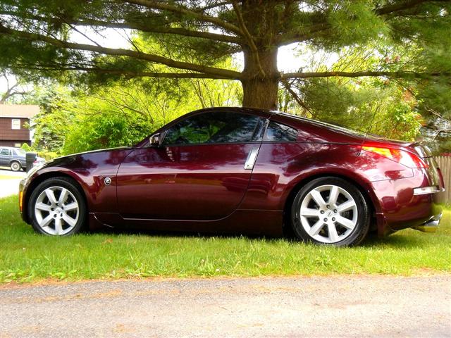

Who gives that much of a **** what their car looks like?
Geez, just look at my car. One layer of Meguiars gold. Thats good enough for me.
Dont be so **** dude, find another fixation in life that doesnt depreciate...

Ed, you have to admit, my car looks nice.

But then again, even DIRTY Brickyards look nice!
