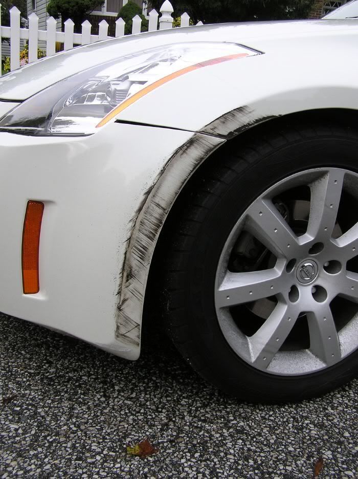

Above: before. This is damage from a truck tire.

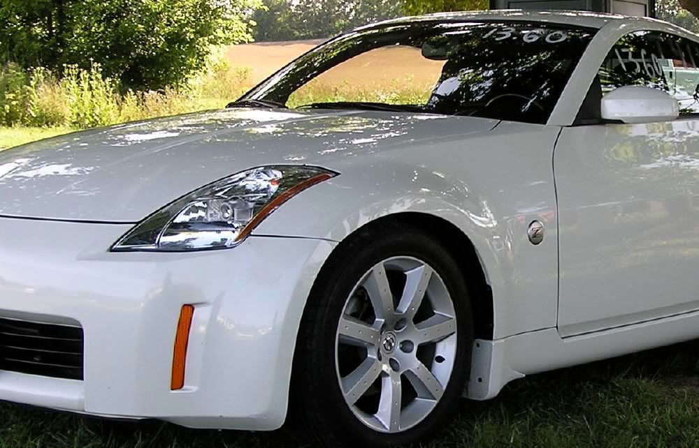

Above: after mineral spirits and Black Magic.

davidv, your pictures looks just like mine, but to a much less extreme extent, but instead of rubber marks, it's paint.

Ok Blazemaster, I've had to clean up a few mates cars in the past to remove paint smudges shall we call them. Anyway, I'd personally stick with the less agressive approaches first. For example, gentle application of clay bar, or my preferance would be cleaner wax as the cleaner wax will lift off most surface nasties. PLEASE don't rub at the paint!!!!!!!! Gentle application, sweeping motions in area should remove. As always a photo would help.
And yes, you do need to re-wax the area afterwards. Don't forget to post an after photo.
Oh, and please don't use Nail Polish Remover, it's evil, it will melt straight through paint as most have an Acetone or Denatonium (which is used in anti-freeze) base. Nail Polish remover will melt through paint in about 3 seconds. http://en.wikipedia.org/wiki/Acetone.
