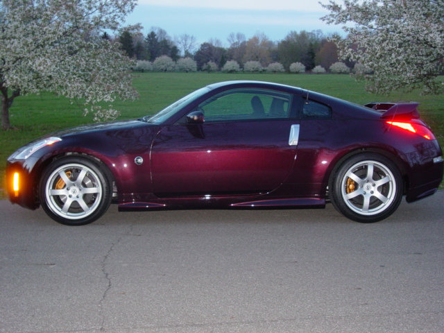

I agree with Ares. I don't use the ZFX anymore. I did when I first started. I now have 32 layers of Zaino on the car (that's just Z-2 and Z-5, not counting the Z-6 between each). I also wash/wax at night and take it off the next morning.
I use the Z-7 wash, the Z-5 for swirls, the Z-2, and of course the Z-6. I used the Zaino Claybar when I first got the car. I use the Zaino tire dressing. It works really nicely. Not too shiny, just right. I use 303 Aerospace protectant on the inside of the car.
I use micro fiber towels (color coded so I know which product goes with which towel). I use a microfiber wash mit for washing.
Here is a link to my editorial I do at Zfrenzy.com. It has all of the detailing products I use and links on where to get them.
Dr Bonz Detailing Product List (with links)

isnt 32 layers of zaino a little overkill? can you really tell any difference between 3 and 32 layers???? i guess the zfx would get a little expensive after 32 layers. somebody's got a lot of time too

I don't see why using the ZFX every time would be a problem
And no, there isn't a visual difference between 32 and say 5 or 6 layers but I'm not doing it for the look. I'm doing it for the protection. This thing is BULLETPROOF now. I am hoping that there will come a time when swirlmarks or scratches won't be in my paint but instead in my Zaino. Then, all I have to do is claybar and start over.
An a BIG NO, I don't have a lot of time. I have done those layers over 9 months and I apply it at night (after I get home from 10-12 hour days) and take it off in the morning on weekends. Like I said, I hardly ever use ZFX anymore.
