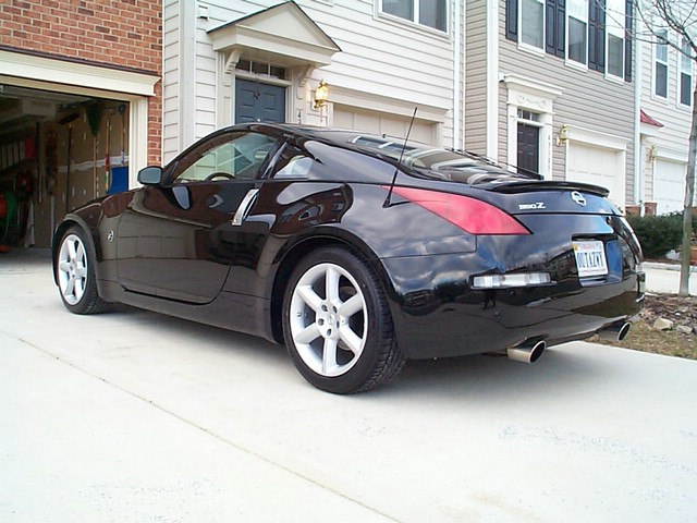

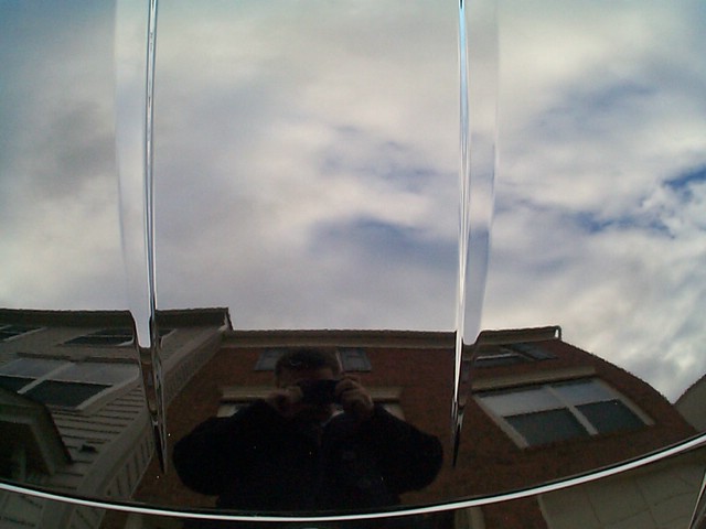

I have some photos after my first wax session, which I'm going to use loosly as a baseline. Unfortunatly those photos were taken in the morning, and the Blackfire photos are taken in the late afternoon. I turned the car to try to get the same side for the photos, but realized afterwards, the big shadow from my neighbors tree really darkened the photos.. but thats later!
What's the problem with my wax? Dust from removal. My biggest issue was having to go over the car several times after polishing before waxing to not trap anything, and then cleaning up after waxing. Also, white stain in the rubber trim is always an issue with carbunua waxes. The Z is an incredibly easy car to wax, but I was looking for a bit more. Durability is of course important, but I didn't have as much an issue with that, as my Blitz applications seemed to hold up well.

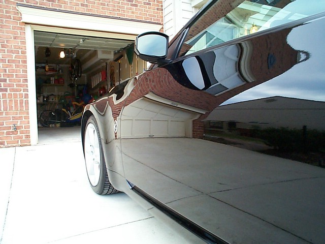

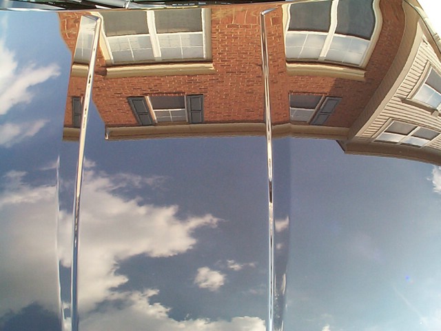

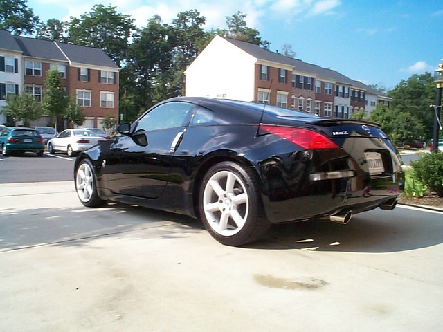

Ok, here is the 'similar' shot with Blackfire. The sun was VERY bright today, so that plays a big factor in this shot.. but the clarity in the house reflection is pretty good.
I should also note.. the hood has been repainted since the original wax photo, and when I got it back from the bodyshop had noticable orange peel where the original hood paint job didn't.

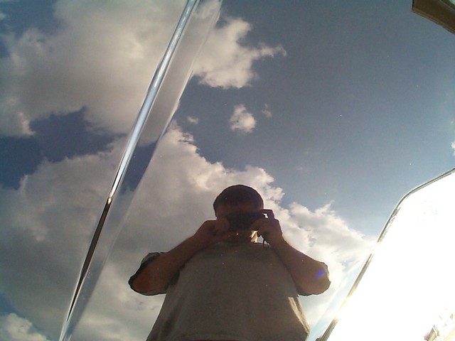

Of course.. what car worship session would be complete without the photo of self shot.
