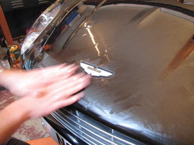

Here is a picture of some wax being applied by hand..........

The best paste waxes are a combination of Carnauba, solvents, emollients, eye-of-newt, snake oil and lubricants, rubbing it on with your bare hands is probably the closest thing to autoerotism for your car. However, it really doesn’t matter how the wax first gets slathered on the paint surface, because it’s the buffing action that removes the excess, creates the friction heat to evaporate the solvents and secret-sauces and leave a micro skim of wax on the paint.
If I’m working in good light, an applicator pad is perfect as I can see that I’m getting complete coverage at the right thickness with no missed spots. If it’s a bit too dark in the garage to see contrast, then spreading the wax with my fingertips is better. Your fingers give good feedback as to when you have an even coat and instantly detect any dry spots. Also it can be easier to get some wax up close to the rubber weather stripping without accidentally tagging it. Double also, if there is a missed a little dot of crap still stuck on the paint after washing/claying, your finger will catch it.
Either way, once I start buffing up some friction and shine, my car doesn’t care, it just doesn’t want me to stop.

^ This above response pretty much sums it up but I'm just going to chime in because of my particular amount of experience with Dodo Juice (my wax of choice) applied both by fingertip and applicator. DJ has a very runny consistency, its not very homogeneous and the applicator pads absolutely slurp up the liquid portion not only causing you to use a lot more product but also leaves you with only the gritty bits left that just wont spread very nice by themselves. Fingertip application is definitely the way to go here, not only are you getting a much better application, you are saving yourself much green as the dodo ain't cheap as you know if you've been shopping.
