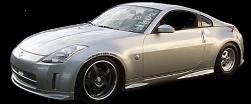

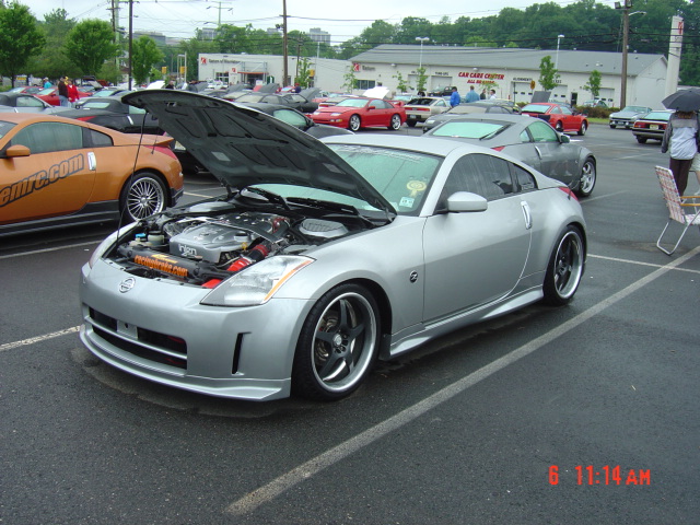

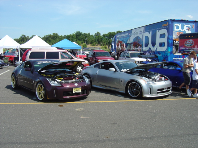

Performance mods include-
APS TT-tuned to 9lbs
XERD Cat pipes
Injen Exhaust
UR Crank Pulley
MRC Grounding Kit :-)
CM Stage 3 clutch- being upgraded soon
Nismo GT Pro LSD @ 60%
Autometer- Boost, EGT, OIL temp, Fuel Press, and Intake temp guages
AEM Wide Band 02
Blitz Turbo Timer/ Peak Boost hold meter
Suspension /Brakes
Eibach Springs
MRC Camber/Traction Rods
JIC Strut Bar
Racing Brake Rotors
Hawk Pads
Inside/Outside
Nismo Bodykit
Roja 19" Formula 5's
Weld Prostars for racing
Polk Audio/ Kicker sound system
+ a few other goodies...
Hows that list !! :-) And yes, stock axles, I have already broken a cv joint racing back when I was NA... So I launch easy now, around 3500 rpms instead of 6000, and I roll off the clutch instead of dumping it... Thats one way to save the axles....
