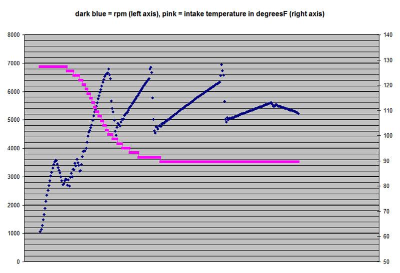

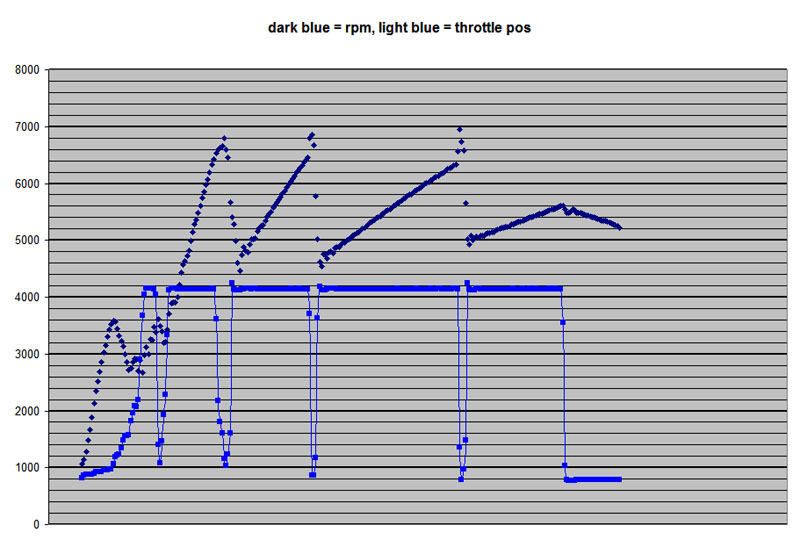

some datalogs
engine RPM versus throttle position, intake temperature (note, temp does not reach ambient of 90F until 3rd gear!!)
Attached Thumbnails Another "my first drag race"-09-23-06_9am_run01.jpg   Another "my first drag race"-09-23-06_9am_temp_run01.jpg

I see you took off real slow,. from ur data logs. Im going on my frist drag on Sunday. Hopefully i wont break the 15s lol

Looks like I can squeeze a bit more power out of 2nd and 3rd gear, shifting too early.

Im at sealevel, at a track known to be prepped good... idk, im not too confident. When are you shifting?

should be obvious from looking at the charts I posted.

No belittling reply here. I reserve that for members who consistently post street kills, but never once, not once, post a time slip.
Put those charts any, and floor the gas peddle will you.
