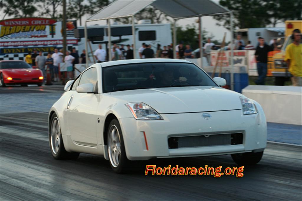

so slipping no nothing... if i get enough power to the wheels i want them to lift the front of my car up. thats the kind of traction im talking about.
Here's what you can expect with 400 hp and some BF DR's
Not even wearing a helmet!? Not running 13's?
Man you got good eyes...Thats me...I didn't have my helmet that day. Bradenton was pretty cool about it, Jay and I usually try to get away with not wearing a helmet.
Yeah, that pic was of CoachK(Tom).
Alberto, you'd be in heaven at Bradenton! They don't check ****
They were letting civics run all day(mid 10 sec) without roll cages. I run 12 flats with no helmet and flip-flops on. The only thing I've been caught on was wearing a wife beater .
