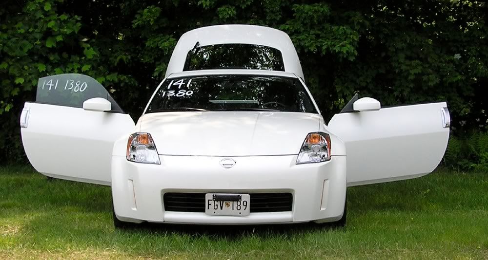

So I knew some people having a drag day last week. It was about 100+ degrees and very humid. I just don't get my drag times. Why are they so slow with all my mods? (Mods can be seen below in sig)
FASTEST SLIP
60' -----2.130
1/8th---9.222
MPH----78.63
1/4-----14.211
MPH----99.75
SECOND FASTEST SLIP
60' -----2.136
1/8th---9.213
MPH----78,46
1/4-----14.215
MPH----99.49
THIRD FASTEST SLIP
60' -----2.198
1/8th---9.255
MPH----78.31
1/4-----14.259
MPH----99.19

Atleast you are consistant.. Its the heat and your 60ft needs some work. But if you running street tires, that can be tough. Once it gets cooler you will have a better time.
You are picking up 21mph in the back 1\8th. Your shifting can improve aswell. You want to pick up around 22 to 24mph. Are you powershifting?

When i was still n/a i would trap 99/100 in 100 degree weather and then trap 102/103 in 50 degree weather. The temps are making your cars ecu pull alot of timing.
Also knock that 60ft down some and you will go a couple more tenths.

You just answered your own question
If you give me the location of the track (zip code), elevation, the date & time, I can calculate the DA's for you just for your future reference.

yeah i think theres a little improvement there in the 60 but the heats gotta have some play in this coz thats not typical with your mods..

Only hardcore racers are out there is July and August. When I am dumb, and decide to race in the summer, this is the best that I can do. I can run 13.4X at the beginning and end of the season. But in the summer, forget it.

Density Altitude was ~2190 feet. Corrected, that is about a ~13.81 @ 102.55mph.
Unless my math is hosed today. Still early and on my first cup of joe.
