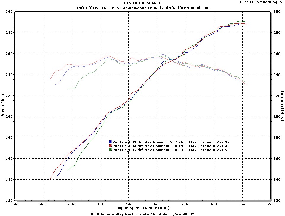

i have an old dyno chart with exhaust, intakes, test pipes, and reflash st 78 degrees(outside temp) and 89% humidity at a 700 feet elevation. It was pouring like crazy that day too. We also used a small teeny fan. It was hot in the shop quickly. I dont know if you call this close to stock?!?
***Disclaimer: this is an old dyno*****

^^also this is NOT a chart where i revved it to 8000rpms.
The new numbers are 302whp/274.6wtq. I will try to retrieve the chart from the shop i went to.
Btw, this is after a UR pulley(which didn't do much), and exhaust leak being fixed.
It was on a 56 degree nice day with three snail looking fans and low humidity.
I also have different wheels now.The first dyno was with 31lb wheels vs the 17 lb wheels i have now. However, i dont think that this matters much anyways.

I trapped 107mph with 262whp. YOU need practice, the car is fine.
edit-I also doubt your peaking at 8000rpm's. No need to shift there after the 1-2 shift. Revise your shift points and hit 4th

The power decreases after 7000rpms. Thats what i figured too, that i am the problem not the car. Thanks Alberto, i would take an advice from you anytime.

If you guys have dyno sheets, find out where you're making max power and shift close to that rpm. No sense going to redline if you're not making power there.
