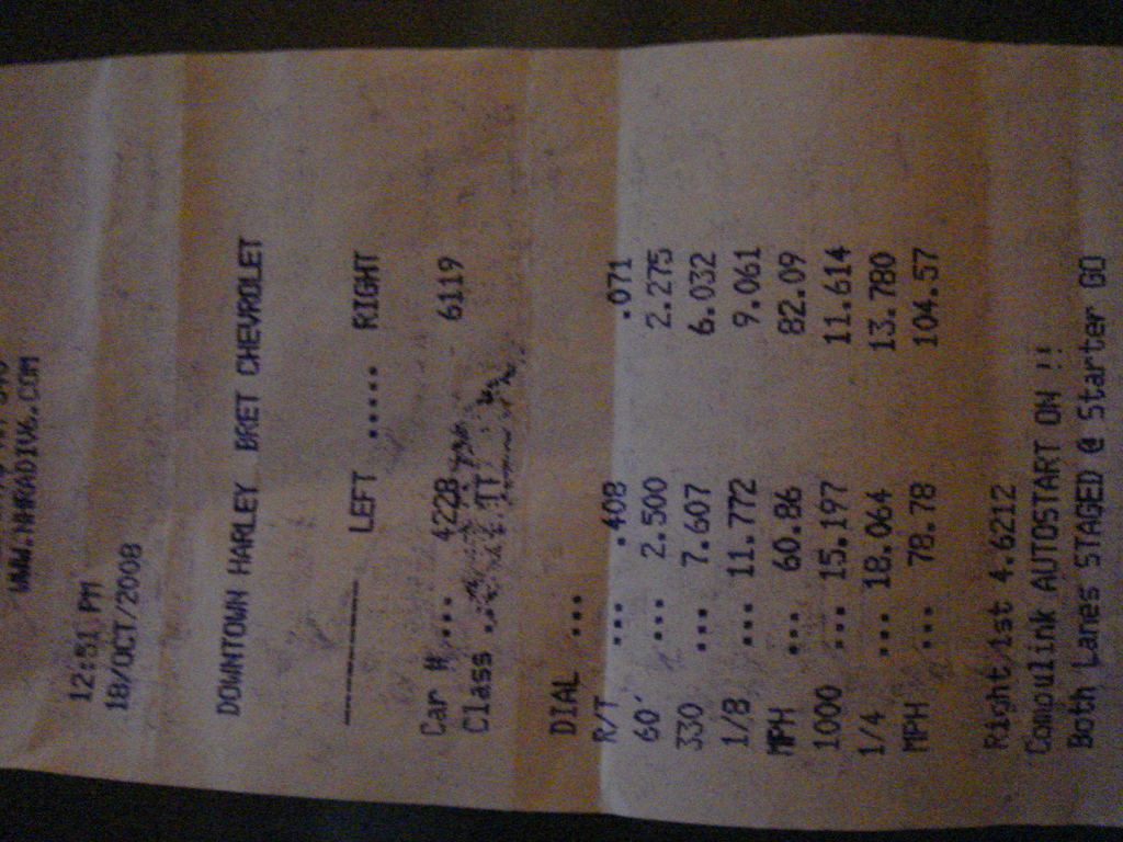

here is the slip 6119 is my number

Originally Posted by gsingh350Z
Good job and nice trap! This looks just like my time-slip..you have an HR engine?
I also had a 2.2 60ft and 13.7 ET. If you want to get a better times I recommend you work on your launch technique and get the 60ft down to 2.0. Once you get it down, it should be downhill from their.
yes, it's an HR and it puts 302whp/274wtq. I expected a lot more. The wheel hopping just kills me. I get it everytime

I didn't realise that this is a HR motor but still you did good.
DA plays a big role in 1/4 mile trap speed. Nothing you can do about it. Still room for improvement off the line, and the first to second gear shift.

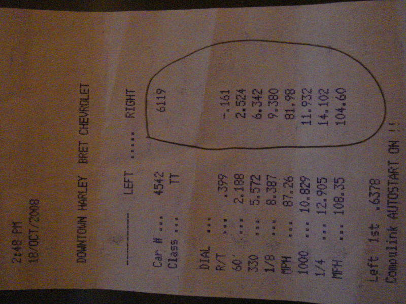

what can you say about this. I red lit it here, and i almost missed 2nd gear, however, i got it in with some little grinding. look at the slip

why is the trap slightly higher than my 13.78 run?
Red light doesn't matter. I assume that you are attempting to get the jump on the car in the other lane. Maybe you are a bit "anxious" with the clutch.
Old Oct 18, 2008 | 09:40 PM
davidv's Avatar
davidv
Posts: 42,753
From: Tucson, AZ
Faster shifting. Pushing each gear to redline. Not sure.
i guess. However, on this particular run i spun a lot.
There are a dozen reasons why the trap speed might have changed. Here are a few that haven't been mentioned.
Were both runs made in the same Density Altitude? Like was one run made during daytime and the other at night?
I've read that if you spin, you might trap a bit higher, and if you really hook, the trap speed can come down a little. But in my experience this has never proven to be true. I have spun a lot and actually trapped lower before.
If you deep stage your trap could be a little lower and if you stage really shallow, it could be a little higher.
Another factor is wind. If you had any difference in wind speed between runs it will impact your trap.
Did you change tire pressure at all between runs? This will surely impact your trap speed. Lower pressure creates more rolling resistance slowing you down.
