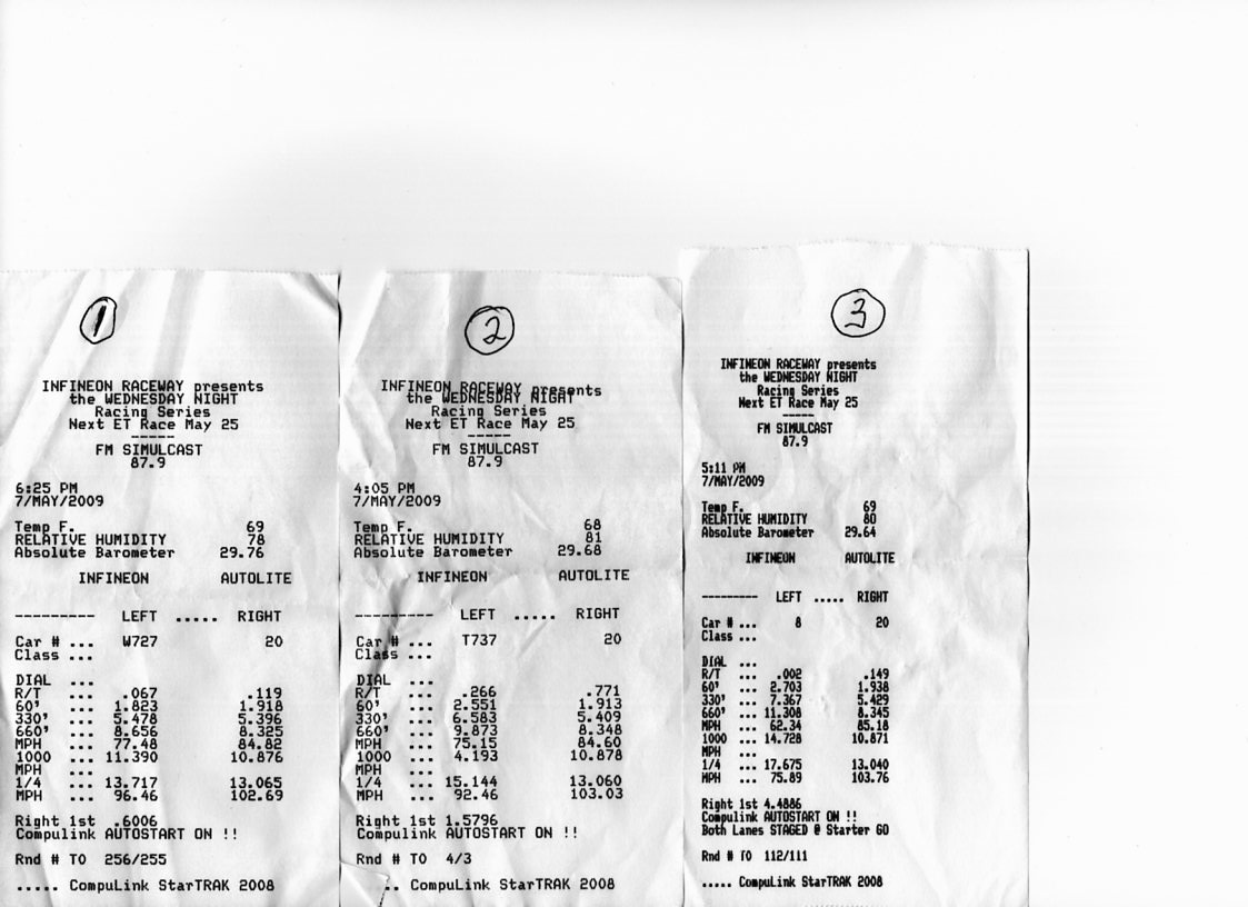

Originally Posted by yaro's350z
you guys are talking about hitting 1.8-9 60' on street tires?
im on 275's and cant get lower than 2.1
care to share the secrets? lol
All the things I do are not recommended by most people who post here. I have 275's on 19" WORK wheels. I lower the psi to 25# burn the tires until I can see smoke in my rear view mirror and then consistently turn 1.9 60 foot times. I launch at only 2500 rpm. (5AT) I was turning 1.9's when I was totally stock, but on 17" tires.
Car
PRACTICE!!
