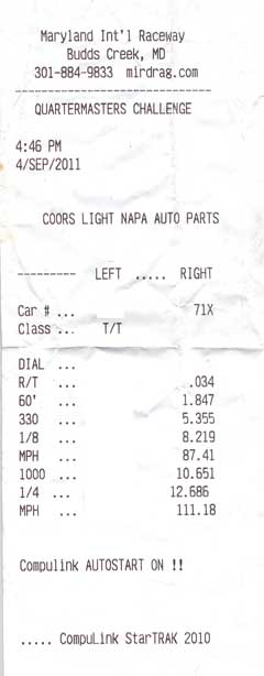

12.6 @ 111mph. I usually trap higher. 100 degrees, 50% humidity, 3500ft DA not helping.
With more practice I can continue to lower my 60 ft, but what point will the axles break on a dead hook given there is zero spin, ever, on my ET Streets? The wrinkle sidewalls seem to be doing their job though.

Congrats on the PB!
Shifting is culprit for the 1/8 being slow and your 1/4 time being off the pace.
For comparison with less power my Z with the same 60ft, would go high 7's in the 1/8 @ 87-90mph and eventually run 11's.
You have the power, you have the 1/8 trap, but the shifts are killing your ET and subsequent 1/4 trap.

It sucks because the car can be a dyno queen (400 + on the dyno) but on the street, and especially track, the tune can turn upside down, and my Uprev engine management is killing me. perceived shift knock and timing retard. The harder you shift the more timing is pulled and power lost on each gear.
i made some changes which helped my E/T on the final run and led to the PB but it's still there. And I'm not even sure if I can fix it based on experiences with a couple others in by boat.
I've got a couple ideas for the next trip to the track to hopefully eliminate/minimize the issue, and bring the times down a bit. Fingers crossed!
