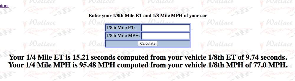

Time:
9.74 @ 77 (Is this normal for a poor driver with the mods I have?)

Ricer arithmetic gives you a 15.21 second quarter mile. Did you stop before the finish line for coffee?

9.74 in not normal. For most new drivers low 9's is IMO "acceptable"
You need serious practice
