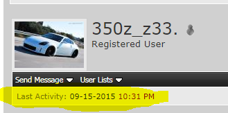

Originally Posted by Faasnu
Did you ever figure out why the monitor never became ready?
he hasnt logged in going on 2 years, might be waiting a bit for an answer
