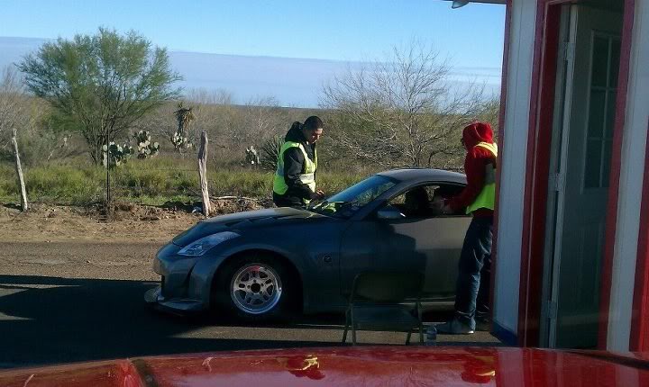

I'm running Bogart D10s 15x3.5 with 26x4.5x15 ET fronts and 15x10 with 26x11.5x15 ET Street radials.
I need to learn how to launch with my six puck clutch!!! I keep breaking OEM axles... I'm on Level 5s now and tomorrow is when I get to test out my new 3.9 final drive and axles. If you guys have tips on how I should launch by all means let me know.

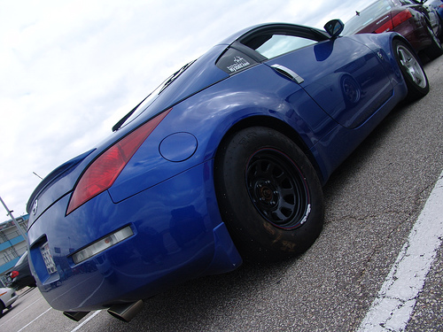

My 15" drag wheels do not fit over the Brembos and no 15" wheels will. I believe you need a minimum of 16" wheels and the correct offsets if you don't want 17".
BTW, I love the full drag set up that some of you guys have. I always wanted to get the fronts to match the Weld Draglites that I had in the back but never got around to getting them.
Here is my last drag set up (28x10.5 ET Streets mounted 15x8 +6, IIRC), before the swap to the Brembos:
