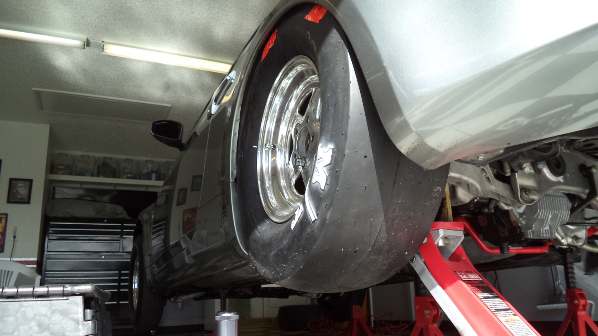

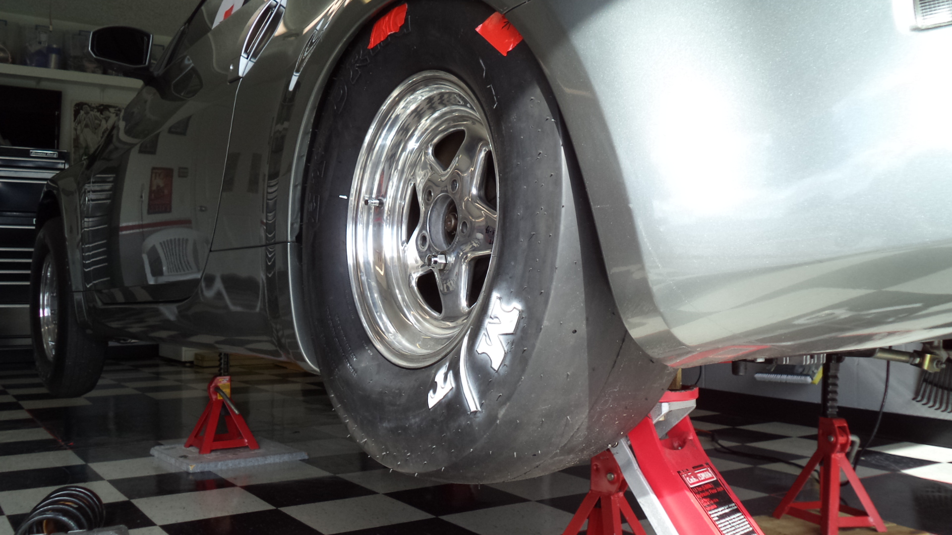

1. New M/T ET Drag 3055S 28x10.5x15, had to modify the inside of the wheel well to fit. One inch taller and one inch wider that my last set of ET Streets. Should keep me off the rev limiter thru the traps and pick up some mph too.

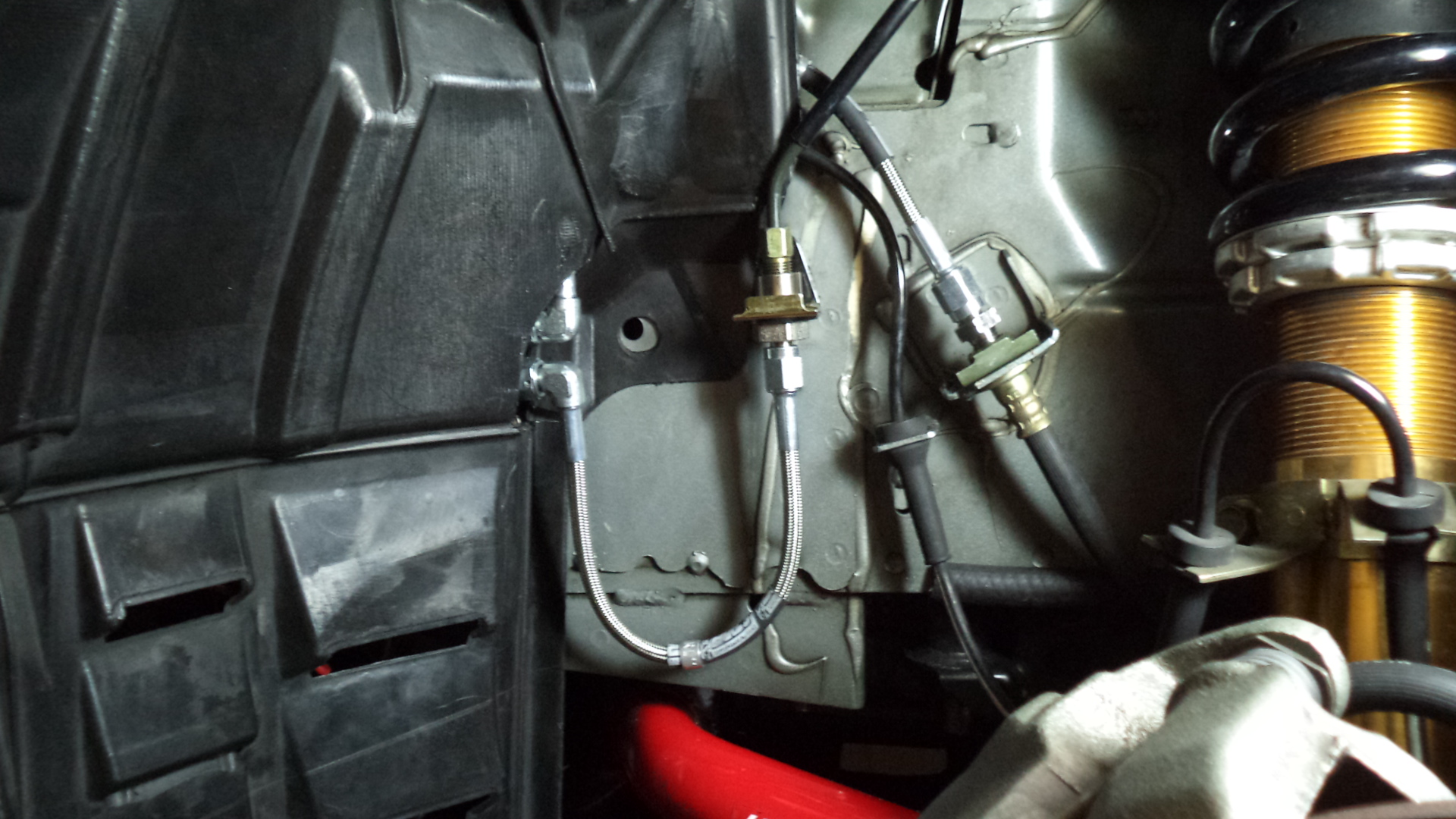

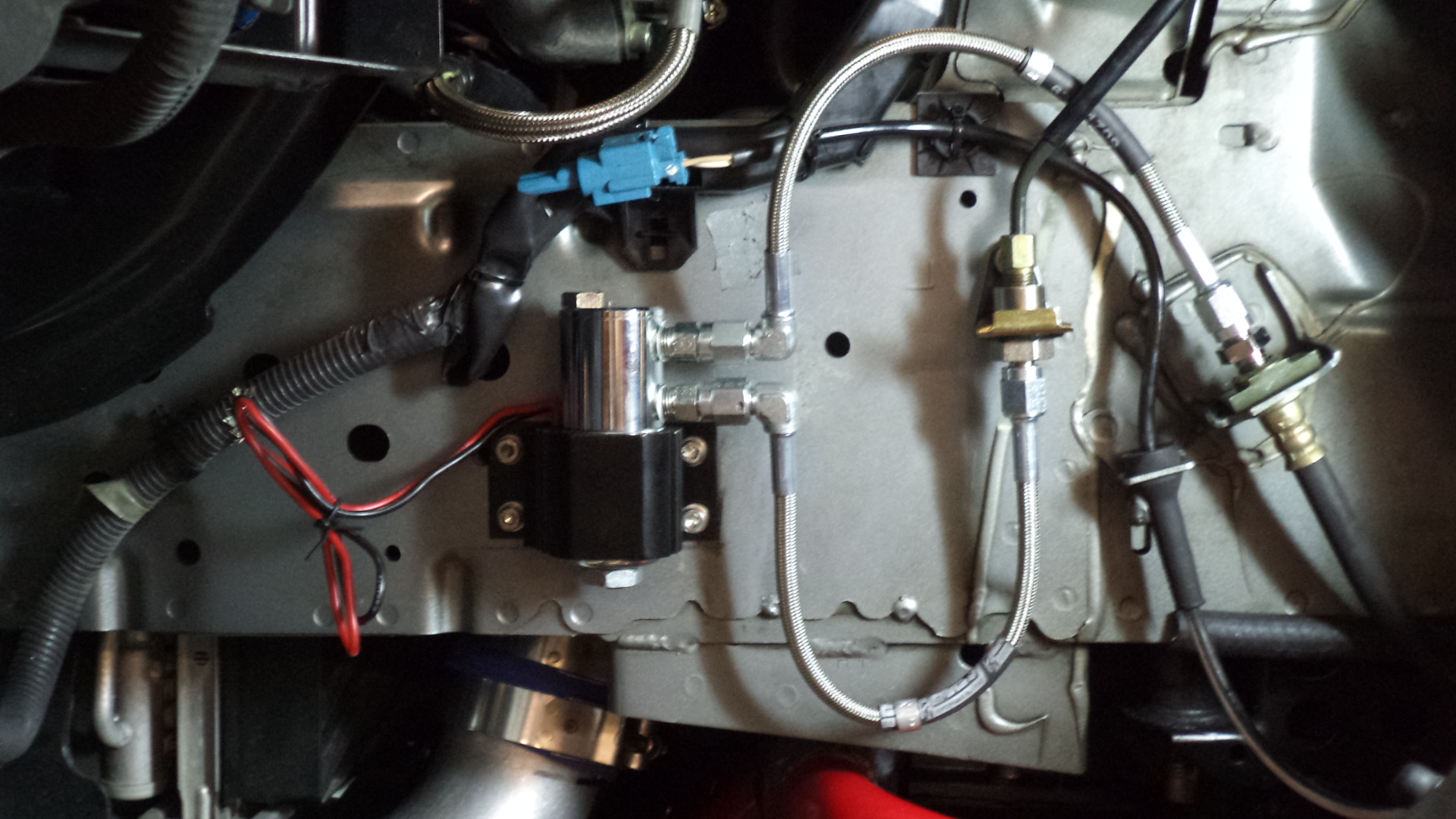

2. Line Locks

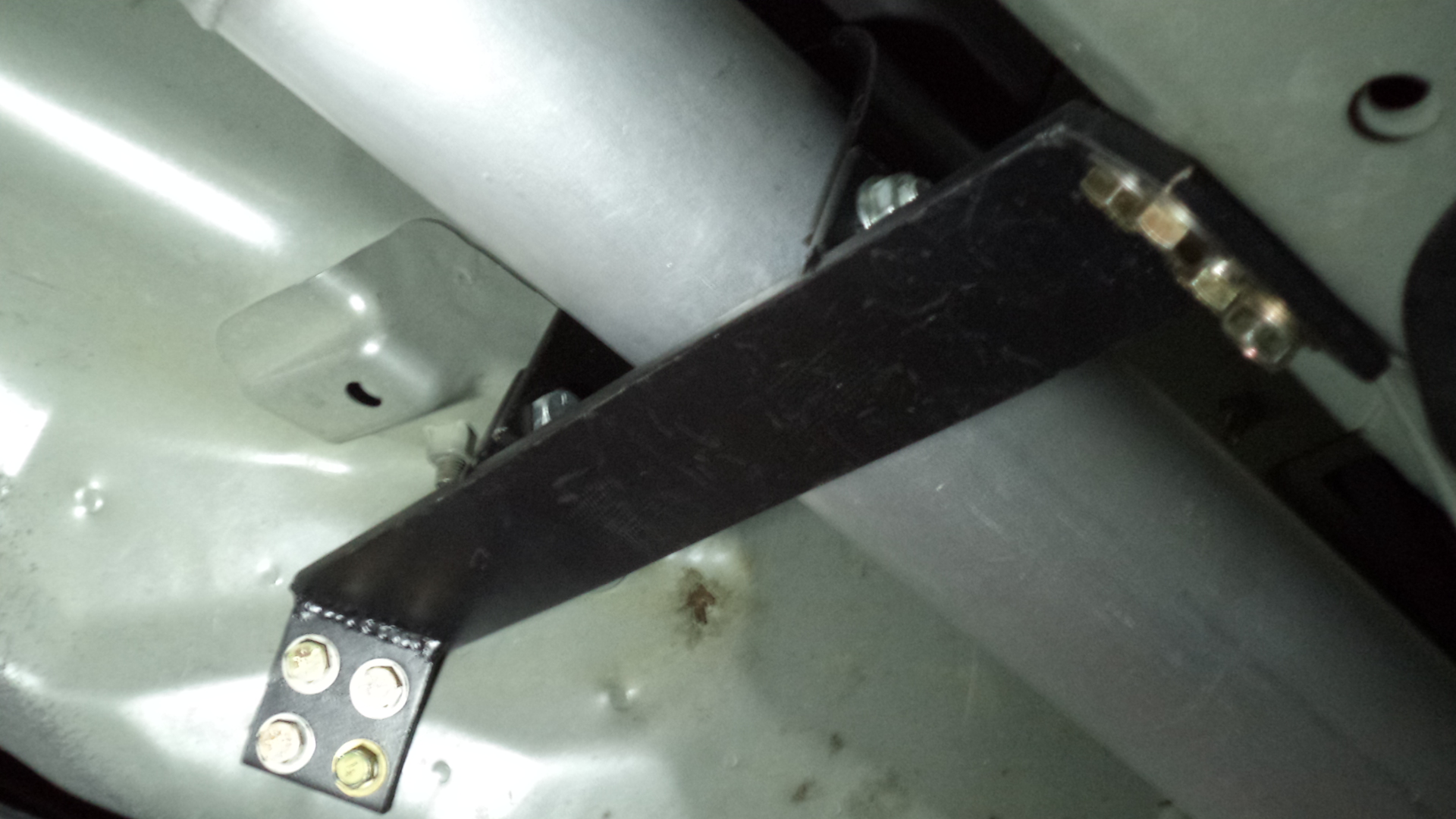

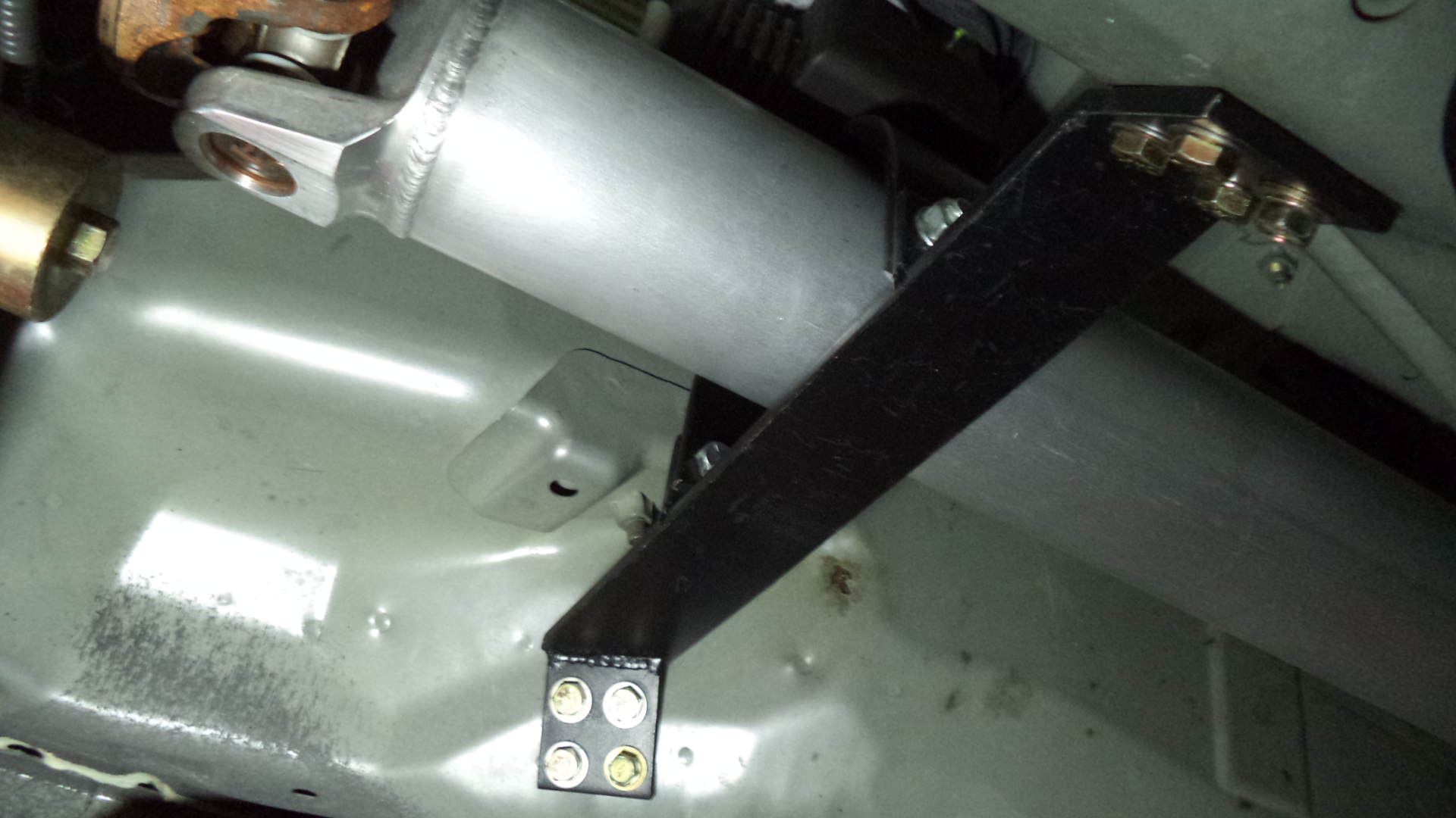

3. DriveShaft Loop required by NHRA ( was already installed for last time out)
