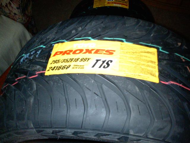

Brian do you have any experience with the Toyo T1-S? I just read the reviews and stats and ordered based on that. They seem really sticky, but its hard to say. The traction is AA and the treadwear is 280 compared to the 040's A and 140 and the S03's AA and 220. I guess I'll find out in a week or two.:-)
The key to traction is sidwall flex and rubber compound. The problem with the wide tires that are low profile is that you get virtually no sidewall flex and you typically have to heat up the tread compounds A LOT before they grip well in a straight line if at all.
I had the S-03s all last summer including a lapping day at Gingerman in which they DEFINITELY got hot....they compound was all mushy and deformed after some hot lapping and my tires got up to the 45psi range from a 35 cold fill...
As for the T1-S's...although they've gotten pretty good reviews, from what I've seen in the real world they wear VERY quickly (the treadwear rating is only useful for comparing tires of the same brand) and get a little greasy once they get hot....S-03 is a better tire in my opinion.

Thanks for the info on the T1-S's. I certainly was not implying that they were better than the Pole Positions. Those are some of the best street tires available.
