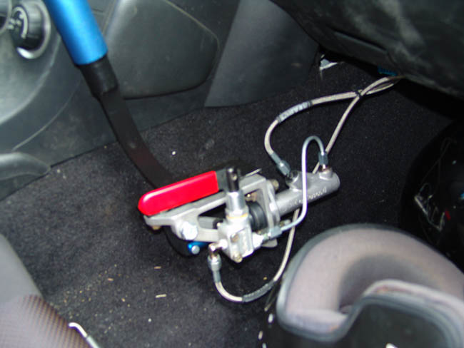

Default hYDRO EBRAKE SET UP.
Hi,
I'm also attempting to install a set up like this as well. the pictures attached are a from a friend of mines car. I talked with the installer and what he did was plumb in-line with the two lines going to rear of the Z out of the abs unit.
First he had to switch the lines coming out of the abs unit because the abs has whats called cross tire braking so he had to switch the lines coming out of it to only the rears. SO ABS must be completely disabled.... wont work as computer thinks when the lines are physically switched coming out of the abs block.
then he tapped in-line with the rear and mounted a wilwood foot brake. inverted and the silly handle is from an aluminum racing jack configured to be mounted on.
He mounted an aluminum L-angle bracket behind the carpet bolted directly to the passenger side tranny tunnel of the car....lots of room behind there...
im probably going to do this and mount on the drivers side and use a removable -not so big - handle. Then use a cotter pin of some sort to keep me from accidently hitting the lever at the foot petal assy accidently.
- J
Attached Thumbnails Hydro E-Brake-aaron350z1.jpg   Hydro E-Brake-aaron350z2.jpg
