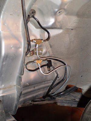

Nackers did exactly what you need here:
https://my350z.com/forum/7339286-post9.html
Remove the passenger wheel well liner and access the existing fitting:
here:
Then go to nackers blog, you can see the rest of how he connected it...
he did this:
Notice here how at 46313 connection he used the Tee fittings im talking about to merge to one line into your Ksport and one line back to the 46313 bottom two lines with another tee:
He (Nackers) however bought adapters and a hardline flare tool because he didnt have the proper metric fittings.
To make it easier, purchase from autozone "asian" hardlines with preinstalled M10x1.0 fittings and then purchase M10x1.0 tee fittings online.
Hint: The bottom left passenger rear of a Nissan 240 has a tee fitting that anyone can get at a local junk yard easy thats M10x1.0
-J
