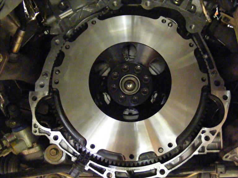

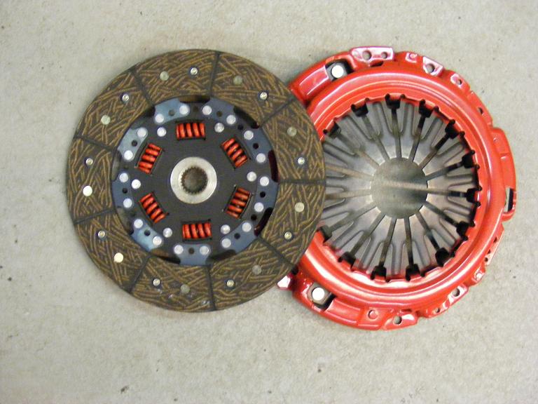

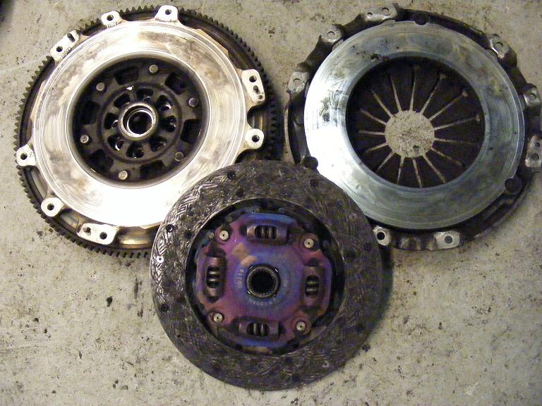

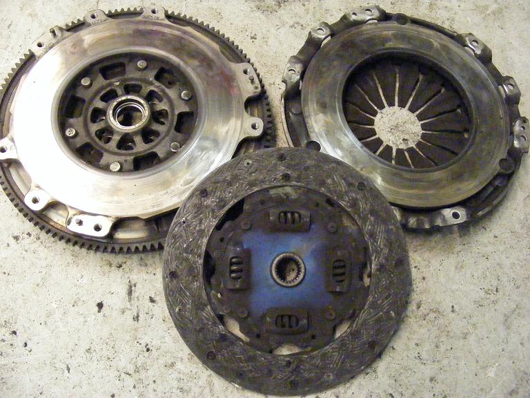

Finally able to post a follow up. Very happy with the work Vuk did, Z1 clutch grabs stronger and faster. There is definitely some noise, but doesn't bother me, and is much less the higher you rev before shifting. He took some pics of the old and new clutch
Mark
