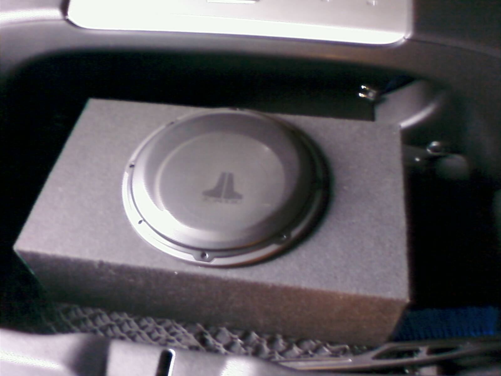

I almost have the exact same box size.
I'm running 22.5x7x13 with 3/4" MDF stuffed with 1.2 pounds of polyfill which emulates an interior volume of approximately 1.0cbft. The main difference is that I mounted a 12" sub. I attached a pic of what it looks like. It actually fits under the strut bar, I just moved it out to take a better pic.

22.5x7x13 with 3/4" MDF = 0.76 cbft. so does the 1.2 pounds of polyfill emulate another .25 cbft. = 1 cbft.?
How close it the magnet to the bottom of the box?
Can i add poly, my magnet will have between 1/4 and 1/2 of clearance.

Are you gonna to make a new floor to cover it all? Don't forget about the part of the sub that sticks out after its been mounted depending on how you create the box. The height of my box is 7inches but its more like 8inches with the sub and grill sticking out.

There is a good article on the net which explains to best amount of polyfill to use (I can't find the article). However, since your box is already at spec of 0.75cbft, you are probably good the way it is.
I can't remember exactly the amount of bottom clearance I have but its very close, like 1cm.
