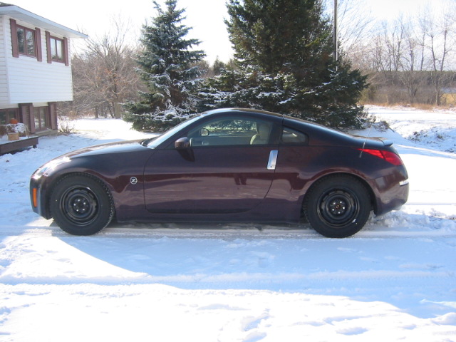

Infinity has 17" steelies which will work on the Z. Or, you can go some real purty 16" rims like the ones on my car.

WOW! you can install 16"? I'm game for winter ugliness. i love downsizing tires for winters. so the stock brakes aren't that big after all.

16" steelies will fit - call your Infinity dealership. If they don't have it, call my local one at 613-749-3501.
BTW, for you Brembo owners, Inifinity has a 17" steelie set that fits over the G35 coupe 6MT Brembo equipped cars as well.

Surprisingly well actually. I drove my 12 second twin turbo RX-7 year round for several winters and it worked good to.
I was a little curious how the 350 would do with so much torque but the VDC does a great job keeping it under control.
I also went with particularily narrow tires (215s) to ensure even better traction. Absolutely lousy performance handling but that's not what they're designed for...

215/60/R16. Small eh?
