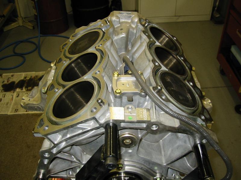

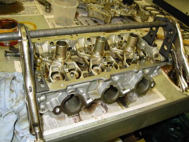

My VQS1 (Almost) is on the way...

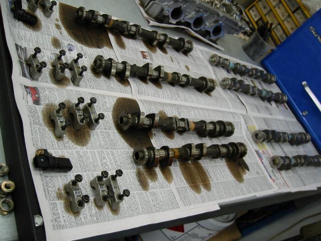

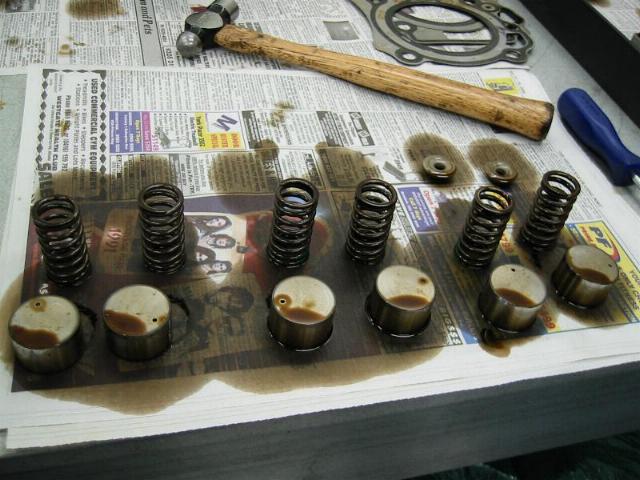

According to my engine builder:
It is necessary to change those valve springs as the standard one will get depressed entirely with those higher lift cams.... so you will need stronger valve springs as suggested by Nismo.
We are still sorting out the torque to the rod bolts now... there are 2 different sayings now...... 1. Stock torque (from Japan Source (from Nismo), 2. Torque suggested by the fax from Nismo Japan again...
will keep you guys posted!
I should have changed those pistons to 11.5:1 right now since it will only take about half an hour or so from here... but well... we can always have a next project to play with a year later, probably can adopt those 46cc nismo heads instead of the pistons...
cheers,
richie
cheers,
richie
