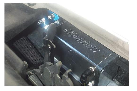

I've mounted mine to the top of the front crash bumper. This picture is from inside the engine bay looking inside the front bumper.

i got some help from Pats300zx but i am still not sure where to connect the oil catch can hoses to. btw, i am not asking for pics of other catch cans installed unless they show where the hoses hook up to. thanks in advance
