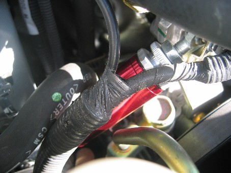

Using the pictures I've posted, I'm just curious which hole(s) everyone is referring to when they say they needed to re-drill it?

It's the piece in the first two pics you posted. Those two holes that are side by side are the culprits. You don't have to re-drill them, per say. We just took a small, heavy duty file and widened out both holes a tiny bit. The holes are either too close together or too far apart (I don't recall which), so you need to widen them a little. It's only a very small amount, though, and isn't as bad as it might sound. I wish I had had a camera during my install so I could've taken some before and after shots of the bracket.

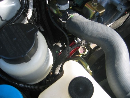

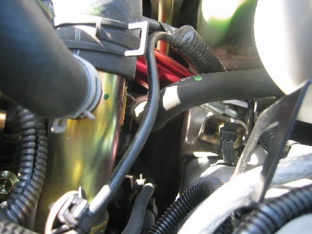

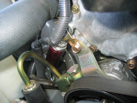

Okay, just got my engine dampener installed & yes it's definitely a pain to get in. Takes about an hour depending on your level of experience. Location was pretty tight. You basically have to make room by taking out your coolant bottle. Also, it seems like Stillen fixed those holes since I didn't have to modify them on mine. Initially, I didn't feel too much of a difference. I did, however, feel that shifting was a bit easier during hard driving. Still have to ride on it for a while to give my full impression. Here's some pics installed.
