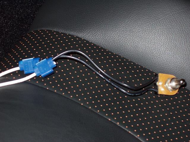

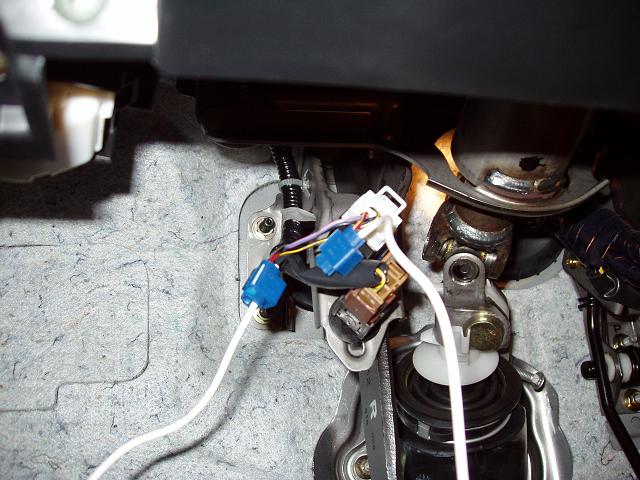

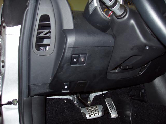

here's what i did; i tapped the red/yellow brake signal wire before it connects to the brake pedal (there are two connectors; brown & white). the white connector contains the red/yellow wire so as i said i tapped it and connected this to a push button switch. then i ran the switch to the blank switch next to the tcs button, and installed it there. and voila, instant burnouts!!!

here's a second pic. this is the switch i used (picked it up at lowes actually).

and a final pic of the switch installed. sorry its a little out of focus, i took the pics right after the install and was in a hurry to try it out.

This is interesting... but are you not risking having your brakes go out on you through this extra wiring ? Especially when you might need them the most (after a burnout?)
you dont lose the ability to use the brakes. it just disables throttle cut-off. however, the brake lights dont work during the burnout. it's the same as pulling the brake fuse without having to access the fuse-box everytime.
