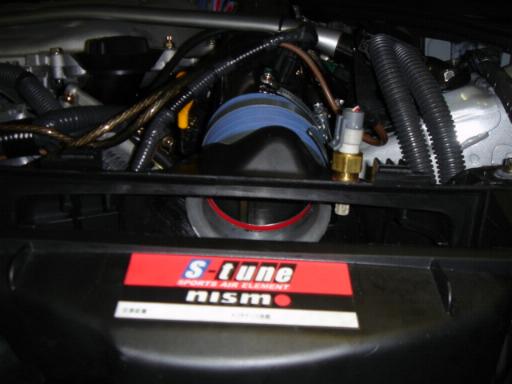

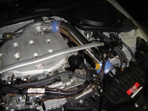

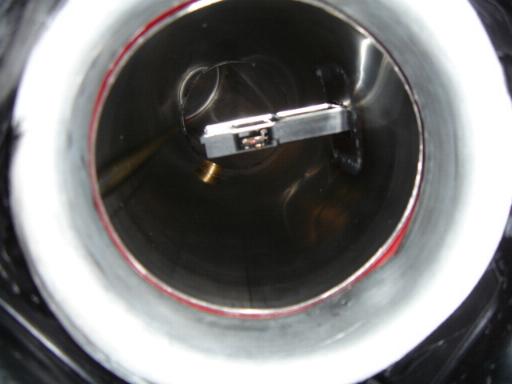

Alright..... Air intake myth BUSTED officially.... done my intake... and no effect what so ever.... the power stays the same.... and now what.... hahahahha.....
This is what we have done to the intake:
1. 84mm bore diameter intake pipe per Nismo (integrated MAF sensor)
2. Larger bell mouth in the standard intake (go down to 84mm at the end)
3. Modify air box
4. Dyno tune..
Same power... (lost 1 rwKW... at the top and a few at the middle range).. since different dyno outputs on different days cannot really be compared... but those are considered as the same power (only 1rwKW diff at the top end, might due to the colder weather)... no gain or loss...
Pics are here... enjoy them!
cheers,
richie
Attached Thumbnails Thinking of a fully built motor w/o FI-1.jpg   Thinking of a fully built motor w/o FI-2.jpg   Thinking of a fully built motor w/o FI-3.jpg

Did you have a bored throttle body also?
