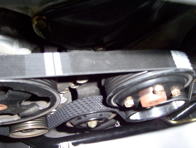

I cross referenced the Gates belts on the Goodyear website and thought I would post them incase someone else wanted to try the Gatorbacks without getting a hard time looking for the part #. This is the belts for the combo of OEM Nissan accessory pulleys with UR crank puley
Part# Belt1= 4040355
Part# Belt2= 4060445
I had to order them from Advanced Auto and am expecting them Tuesday. Install will be Saturday. I'll post a follow-up on if it cleared up the noise from the pulley. The Gatorbacks are impressive looking belts. Very grippy
Got anxious and installed them yesterday. Belts work great, no noise at startup, no ee-ee-ee noise at idle. If you have pulley noise definetly try these belts!!
