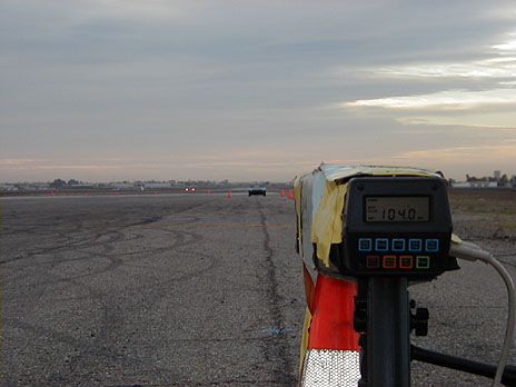

Stoptech used my car a couple of weeks ago to run braking tests. Me and my Z were there all day and I left with a prototype stoptech front braking system.
Steve, who is the "brake dork" with ALL the brake info told me to wait until the 10 of Dec when he will do even more testing on 3 more Z's to perfect their braking system.
Well on the 10 (the other day) they tested a base model, performance model and a track model to determine and build the best braking system, They completed the tests and determined that they now have what will be marketed as their customized Stoptech braking system specifically for the Z. He told me he would be designing my system and shipping it out next week. Different sized piston configuration that will increase the ability to stop faster.
To sum it up, the best system for the car is the 13.1 inch Stoptech system that will be marketed almost immediately. (it will be differect than current ones out there) and the good thing (meaning less money) is that there is no need for the 4 wheel system as it did not improve braking over the stock (touring) brakes. (I love honesty)
What he did say that did impress me is that this new system will shorten stopping distances even more so than the Brembo's on the track model! He said the 100 - 0 stopping distance decreased by 15'!
Thats right, BETTER than the Brembos! No need for 14 inch (more weight than neccesary unless your on the track) or rear upgrades either! Stick with the 13.1 front system only along with the stainless steel brake lines and stop on that dime!

they did runs of about 6 each from 60 - 0, from 80 - 0 and from 100 - 0. Most of the runs showed the better stopping distances.
The idea was to heat the braking system up (simulating racing conditions) and see how they held up. The more braking the more they stayed the same (stopping distance)
It seems the best part is that they stay cooler and will resist fading as opposed to the factory brakes.
The difference in the systems out now and what will be delivered starting next week of so is that the brake pistons were re-sized to give optimal stopping as well as optimal front/rear combined stopping.
From Steve, who knows brakes better than almost EVERYONE, the 13.1's for the front are now the way to go!

I want to clarify some of data reported in the lead thread. StopTech ran mulitiple brake tests on the 350Z Performance model and the track model. We recorded similiar average stopping distances for both 350Z models but the track model had lower rotor temperatures as expected.
We changed out the stock brakes on the Performance model for the StopTech brakes and then repeated the 60-0, 80-0 and 100-0 tests. Using the same tires, driver and track on the same day.
The 332 front only StopTech kit and the 355 front only StopTech kit beat the track and performance model average stopping distances by 3, 4 and 5 feet in the 60, 80 and 100 to 0 tests respectively. The 332 StopTech kit had lower average front rotor temperatures than the track model.
The 355 front StopTech kit had even lower average temps as would be expected from a larger rotor.
This was our second test day for the 350Z. The first test results showed that we needed a new caliper piston size combo to optimize the stopping distances for the 332 kit. We went back to the plant and manufactured the new caliper size. On Wednesday we proved that the new size was indeed ideal. We will be changing out the All_bark calipers next week so he will have the optimum sizes.
Stopping distances are pretty much dictated by traction which is pretty much dictated by the tire's grip on the road. True in any single stop measurement where fade has not yet had a chance to set in. It worries me very much that they claim a shorter stopping distance. I doubt that very much. Just as the Track's Brembos will not stop any shorter than the standard Z brakes in a 1 stop situation.
