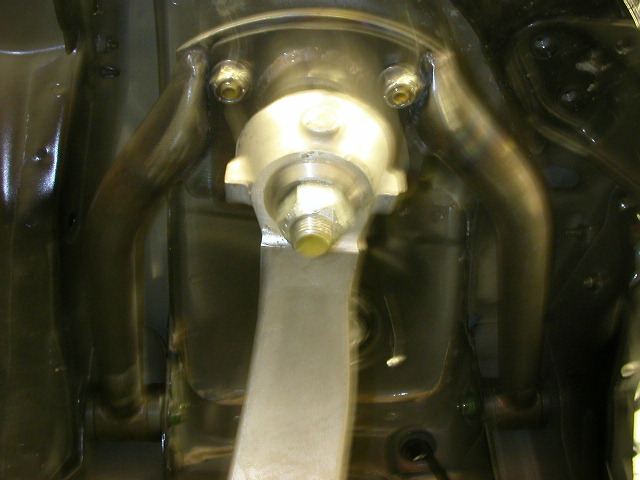

Old Dec 22, 2002 | 10:43 AM
dwnshift's Avatar
dwnshift
Posts: 1,514
From: Cincinnati
Here is our solution.........sorry for the bad picture...........
Its our new upper control arm which allows camber adjustment. Keep in ind this is just the first one. We are not allowed to run AL arms in our series.
