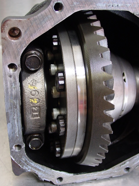

Got an email from Quaife about the test fitting and here's the response.
"On 10/6/2005 I communicated our success with the build-up to your dealer, Forged Internals. I had hoped that the good news would be disseminated. The work was performed on a third member set up for the 2005 SEMA show car belonging to a prominent air filter company, and was done by our local Infiniti dealer. Everything works perfectly. We also recently received great feedback from a race team in Puerto Rico that has already installed the diffs, spacers, and bolts with great success. They report, "We test Quaife differentials on our (2)350Z and works great check photos of both cars. Ours cars improves top speed and corner traction. Also there's a difference in weight loss(6 to 8 pounds)."
I am confident that "all will work" and I'm sure that you will all soon be enjoying the benefits of a QUAIFE Automatic Torque Biasing Differential.
Attached are also a couple of pictures of the post build-up.
BTW - the new bolts require NO washers.
Kind regards,
Harleigh Williams
Quaife Aftermarket Manager
So looks like we are good to go for those of us who have to use the spacer and new bolts.

Yes, it will fit a VLSD diff but you need the spacer and bolts. In the attachment you can clearly see the spacer sandwiched in between the diff and the ring gear.
