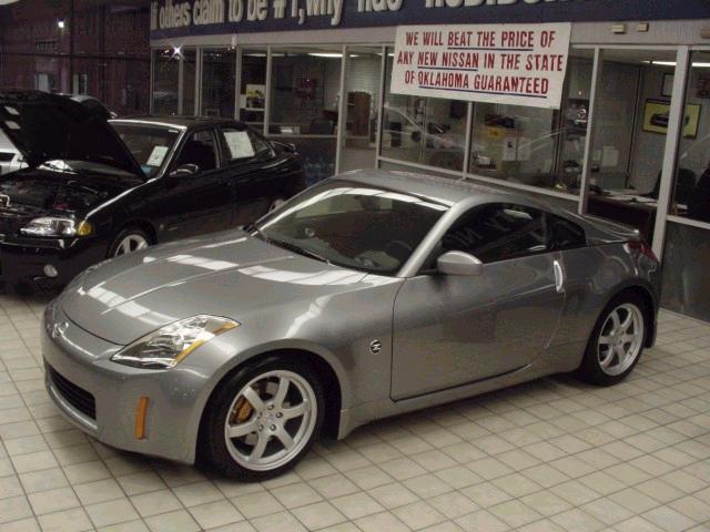

I plan on meeting the 1/21. How much was that kit? Next time if you see a young short guy w/ spikey messed up hair due, flash your lights and stop me. I want to check out your car. Hogan
