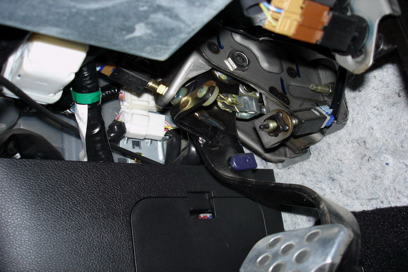

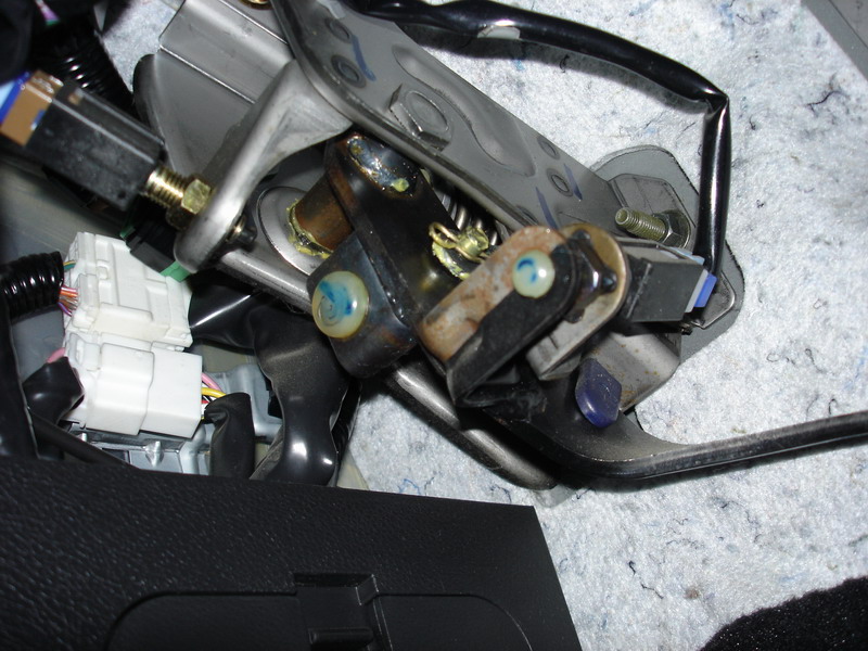

Old Feb 22, 2006 | 08:13 PM
eat rice z33's Avatar
eat rice z33
Posts: 1,553
From: ct
ok well first check the obvious, so go under your dash and just do a visual confirmation that the clutch pedal is attached to the clutch fork VIA a shaft and a cotter pin. Then come back well help you
Old Feb 22, 2006 | 08:19 PM
Will Pwr's Avatar
Will Pwr
Joined: Nov 2005
Posts: 1,276
From: SO CALI
I can send you the clutch section of the service manual in pdf if you want...it covers how to bleed as well as show a diagram of the pedal assembly
Old Feb 22, 2006 | 08:29 PM
InsaneChink's Avatar
InsaneChink
Joined: Jul 2005
Posts: 872
From: Los angeles
looks like everything is ok
