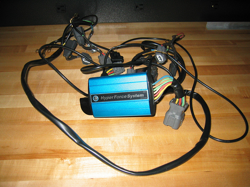

so this a basically a amplified box to the coilpacks?
Does anyone have more pictures of this setup out of the box ?
Im checking goggle and all it shows it the blue box, what else is envoled in the install ? I would like to see if I can benifit off this unit for my 04 Maxima.
Also is anyone using this setup with n2o/boost yet ?

can someone shoot me more info , is it just a postive negative to the box ? and a plug in to the coil packs ?

Here's some pics of mine I took installed and out of the box. There is a main power lead that you connect to the battery and then the rest of the wire loom contains jumpers that connect between inline with each individual coil. Small fingers and/or patience helps with the install.

Cool thanks for the pics , now I can visual see the harness for the coilpacks..
